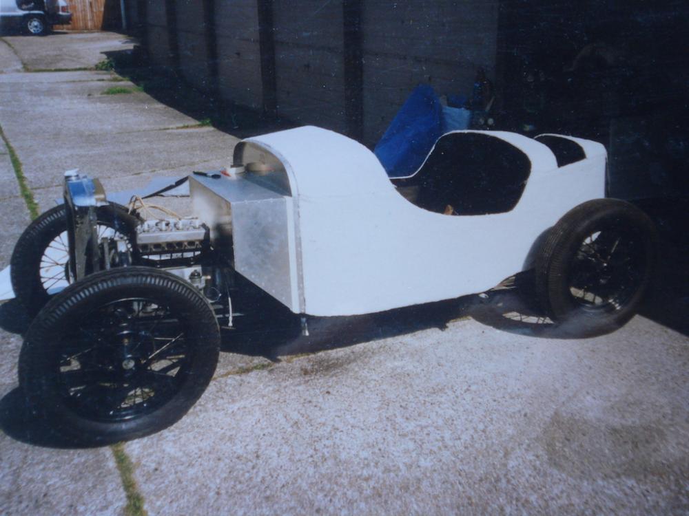

Food for thought.  Ian, your special looked a handsome car and similar to the look I was after. It seems I can drastically reduce the thickness of the skins of the sandwich I was considering and even leave one out!!

Having built various specials over the years, I would advocate using plywood! Never mind the expensive aircraft grade stuff, we are talking about Austin 7's. I use normal birch plywood in 3mm and 4mm thickness, if you build up the edges by laminating so they are around 12mm thick you get an incredibly strong structure. I use Evostick Resin W glue (the waterproof variety).
The Pytchley Special was built this way, the floorpan was based on my RL saloon and was made out of a single 8' x 4' sheet of 10mm plywood with 1" x 1" ash timbers along the edges of the transmission tunnel and rear heelboard.
If I was building an open Austin 7 special, I would base the body on an MG M-Type or Austin 7 Mulliner, similar to Ian's car featured above.

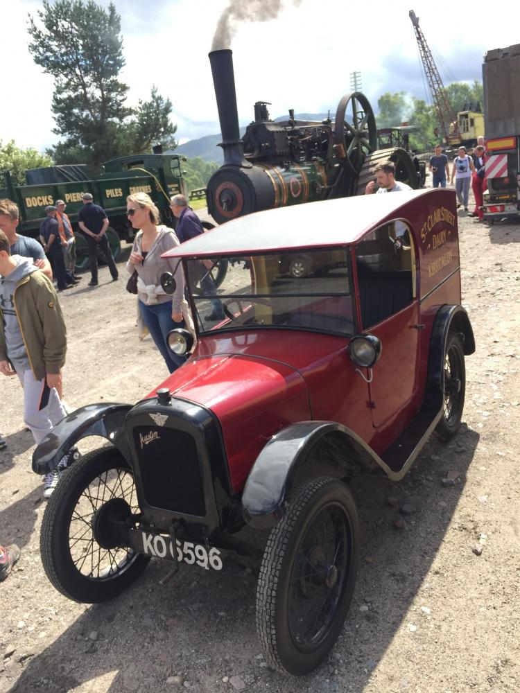

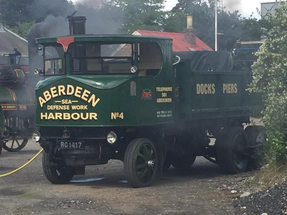

The village station had a steam fair on today - we went in the ‘29 saloon and spotted another Seven...
Several friends of Hedd’s were in attendance.
Brilliant I bet the smell was fabulous!
