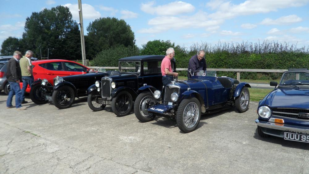

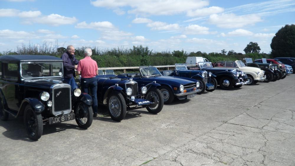

Three generations of the Mason family attended Norwood Park (Nottinghamshire) Classic Car Show. Only two pre war Austin’s there my Ruby and a 10/4.
