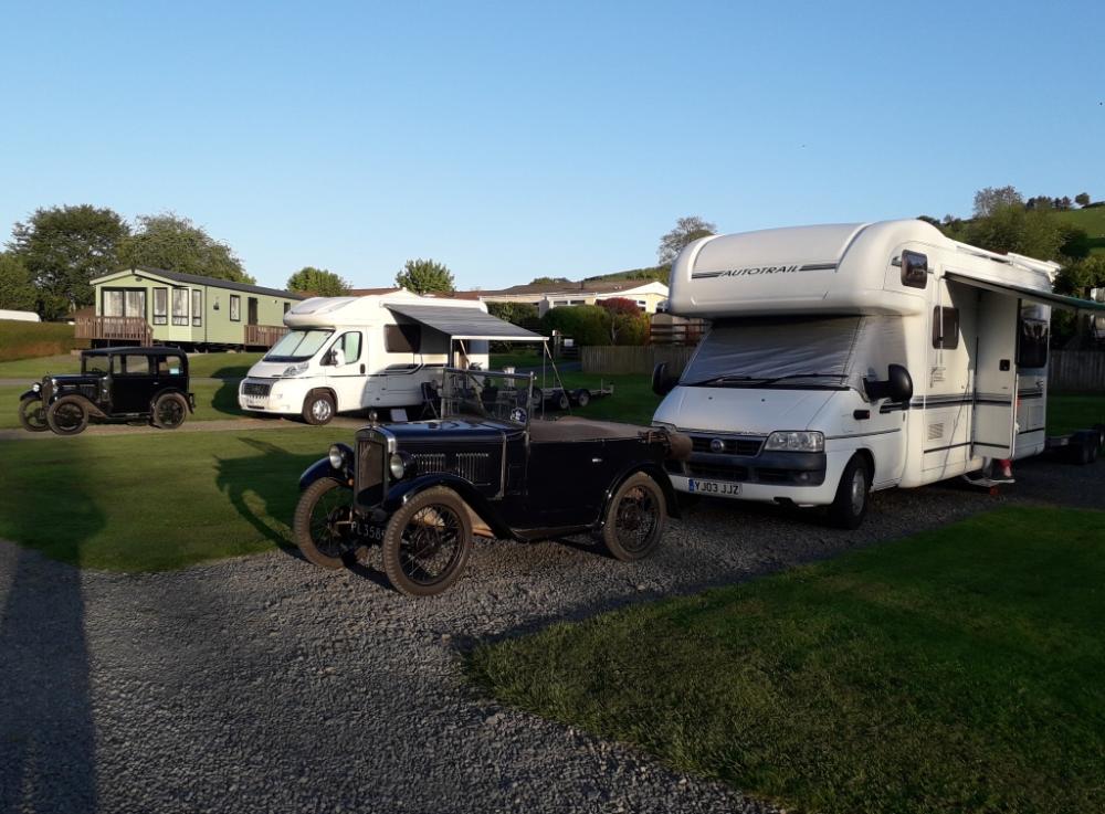

Well, the last 7 days. Based at Presteigne, we've toured the various border towns and villages. Kington, Presteigne, Montgomery, Ludlow, Leominster, Pembridge, Knighton etc. Our two Sevens have never missed a beat each doing over 200 miles in the week even though we do push them rather. Perfect weather on roads that were quiet compared with how it is at home. The Highway Authorities in Shropshire and Herefordshire could do to spend a bob or two on their roads though. Steering to try to avoid the multitude of pot holes became an art form. In contrast, the Welsh roads were not too bad at all.
