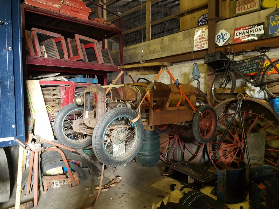

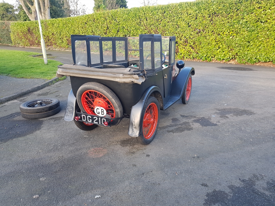

I put a full helping of red wheels on the chummy. And fetched the Gordon England down from the roof to take the transmission tunnel off
[Image: 008_1728.jpg]
[Image: 008_1727.jpg]
