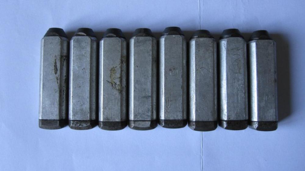

Never used these (and not inclined to try), came with a box of bits but they look a bit more "engineered" than some, does anybody recognize them?
#35
They are aluminium with steel caps, intended to reduce weight and valve bounce in a high rpm race engine. I have not personally gone down this route so cant comment first hand on their effectiveness, although I have heard claims of success.
