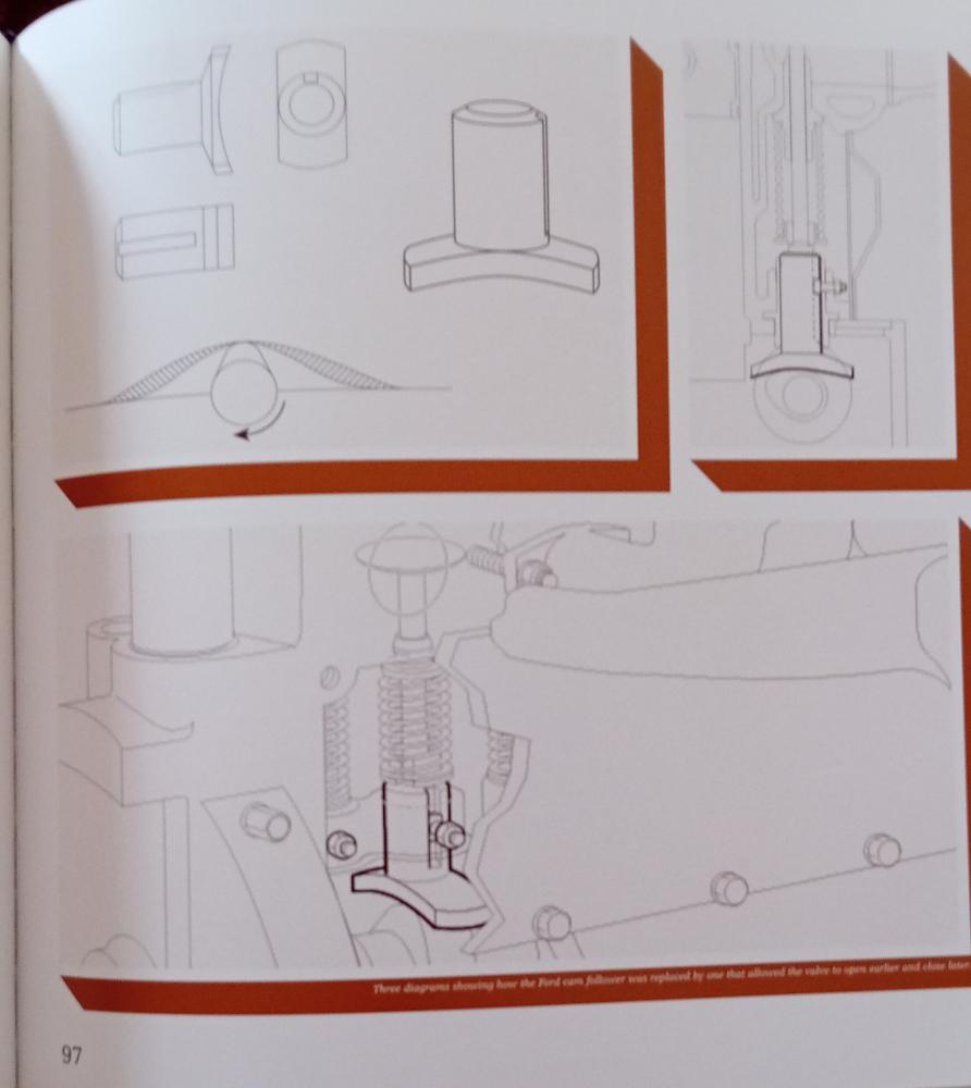

I have often wondered if, using the brass cam follower guides from a very early block,  it might be possible to manufacture and fit some fiendishly clever cam followers like those a certain Mr Chapman made for the Ford 1172.
There's probably a good reason why no-one has.
RE: Modified Cam Followers - Alan - 21-08-2024
There is a very good reason. There are at least two people who will grind you a cam that works with standard tappets more cheaply than doing complicated modifications. I’m not saying Chapman was wrong, merely the cam grinders I’m thinking of probably weren’t born yet.
RE: Modified Cam Followers - Ruairidh Dunford - 21-08-2024
Tim's followers, are very like a variety produced by Cambridge Engineering, only they were drilled too.
