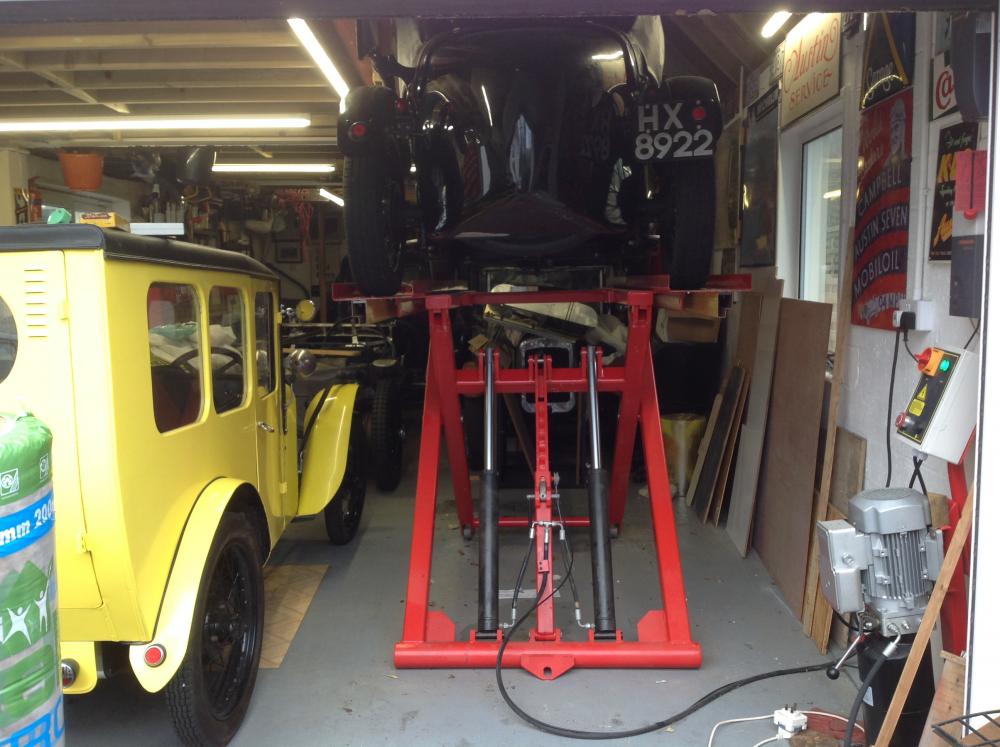

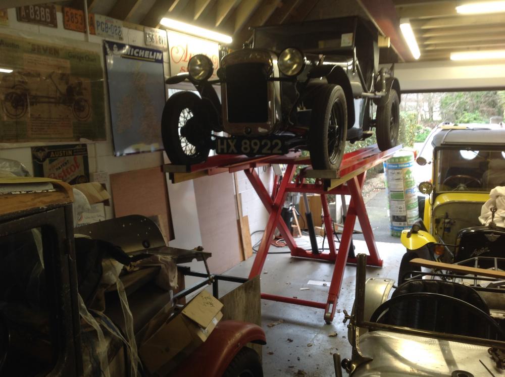

Hi. I am interested in your modification of your scissor lift, what size channel have you used and how are the channels fixed to the structure, are they a permanent fixture or can they be removed so other vehicles can be used on the lift, would love to see some more photos, looks a brilliant job.
08-03-2021, 09:34 AM
Which posting Peter ?
08-03-2021, 05:18 PM
Sorry it was your post, thank you
08-03-2021, 11:50 PM
Ramp at full lift,1.2mtrs.I have made some cross beams which slot across the channels to lift the axles (As MOT ramps) using scissor jacks to work on the car at a better height than the floor.
I had the channels folded in 3mm but would now have them folded in 4mm as they weren't stiff enough and reinforced them with the industrial racking bars (Free) It would be possible to remove /unbolt the folded channels and fit the reach arms but would be a bit of a faff to do. I don't have the space for a 2 or 4 poster,For a Seven this takes up virtually no more space. For any ramp you will need a high roof,Although by hooking up with the hydraulic pump it is possible to wheel it outside if you have a concrete base or similar. A friend of mine has a saying,"You won't get a mower that does everything" Same goes for ramps,Lathes and milling machines
09-03-2021, 08:42 AM
That's brilliant thank you, it shows just what i wanted, I think this is the best method to lift a 7 on that type of ramp because of the narrow wheelbase other than going for the 900mm version which maybe a bit unstable with a bigger car on.
I guess if only working on the corners of the car a sheet of 12mm ply or sterling board over the lift surface would work and a jack to raise it from there |
