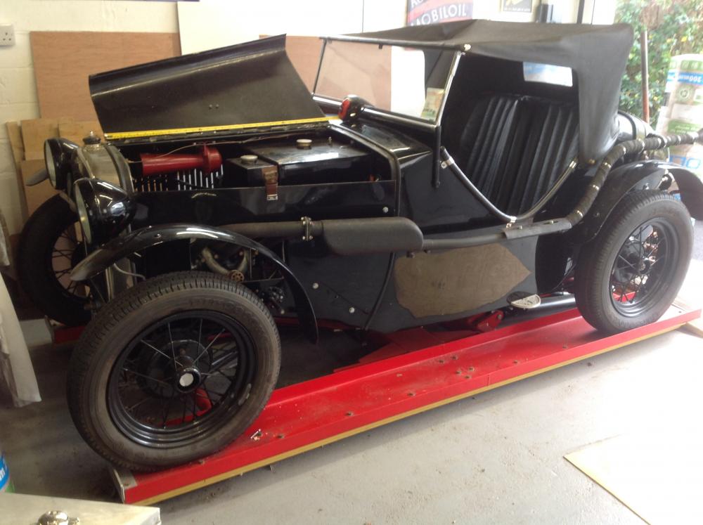

I compromised with a scissor lift.It does have its limitations,only lifts to 1.2mtrs and you can only work under one end .
This was off Ebay less than £1200.I added the channels instead of using the arms that came with it and cross beams to jack the axles off the ramp when then car is lifted.
