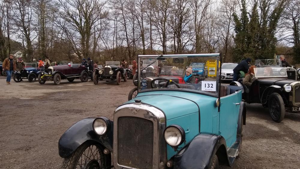

Scrutineering at the VSCC Exmoor trial. Sadly we had to retire with a broken cowhorn which somehow was causing the throttle to stick open.
As the weight of the wing twists the unsupported flitch plate, it twists the floor pan which cockles the throttle linkage bar and stops the rod returning fully.

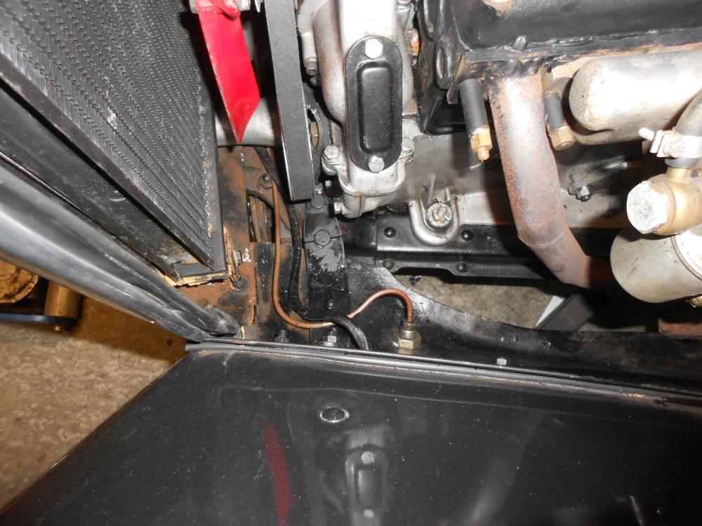

It happened on the RP as well in the same place:
