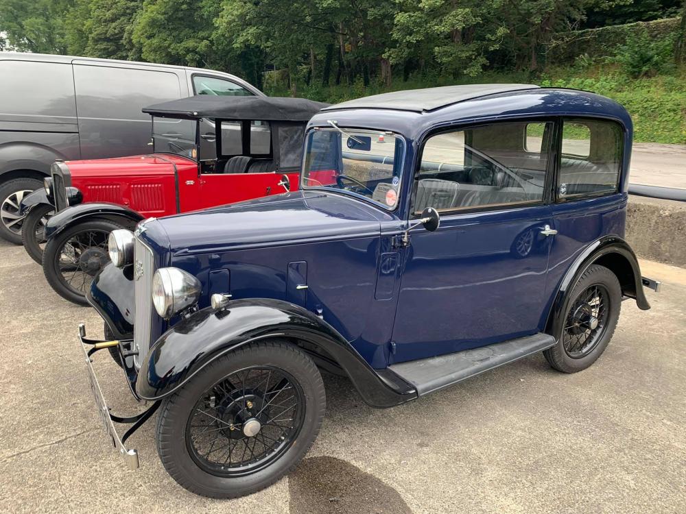

Love the shot in the High Street with the two Austins side by side taking up about the same space as a a BMW 5 series!

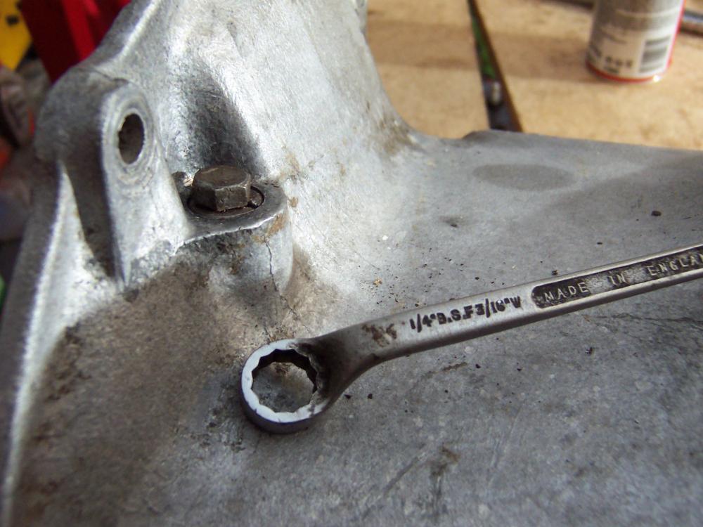

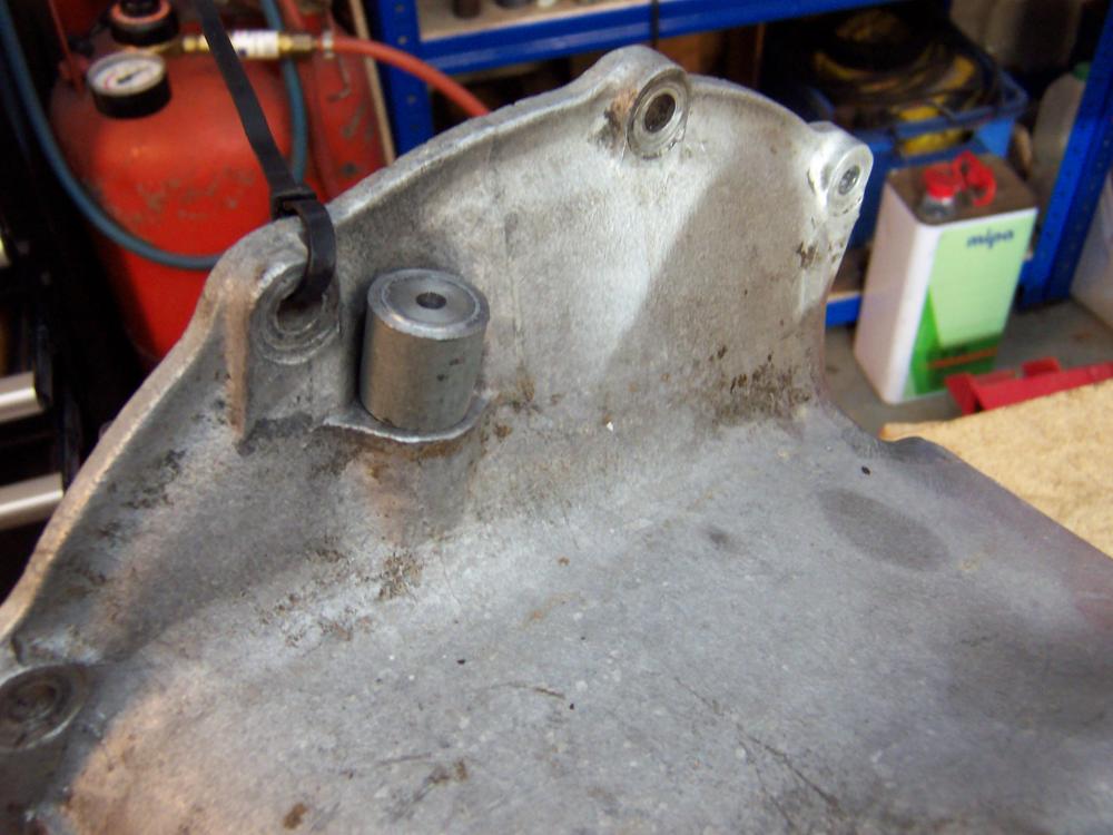

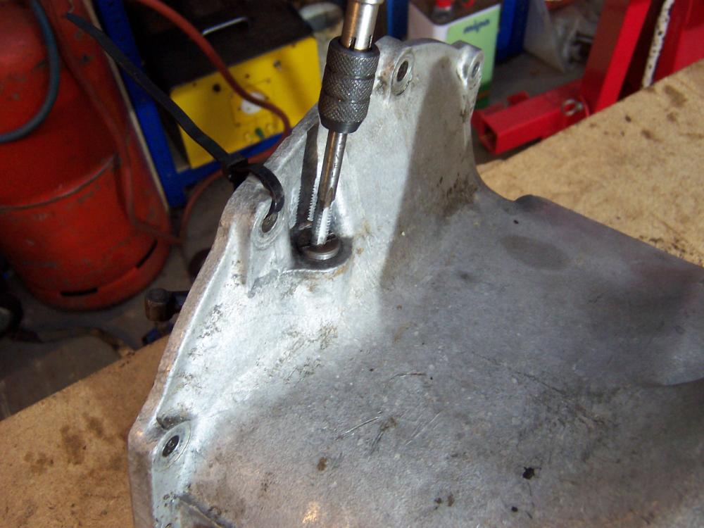

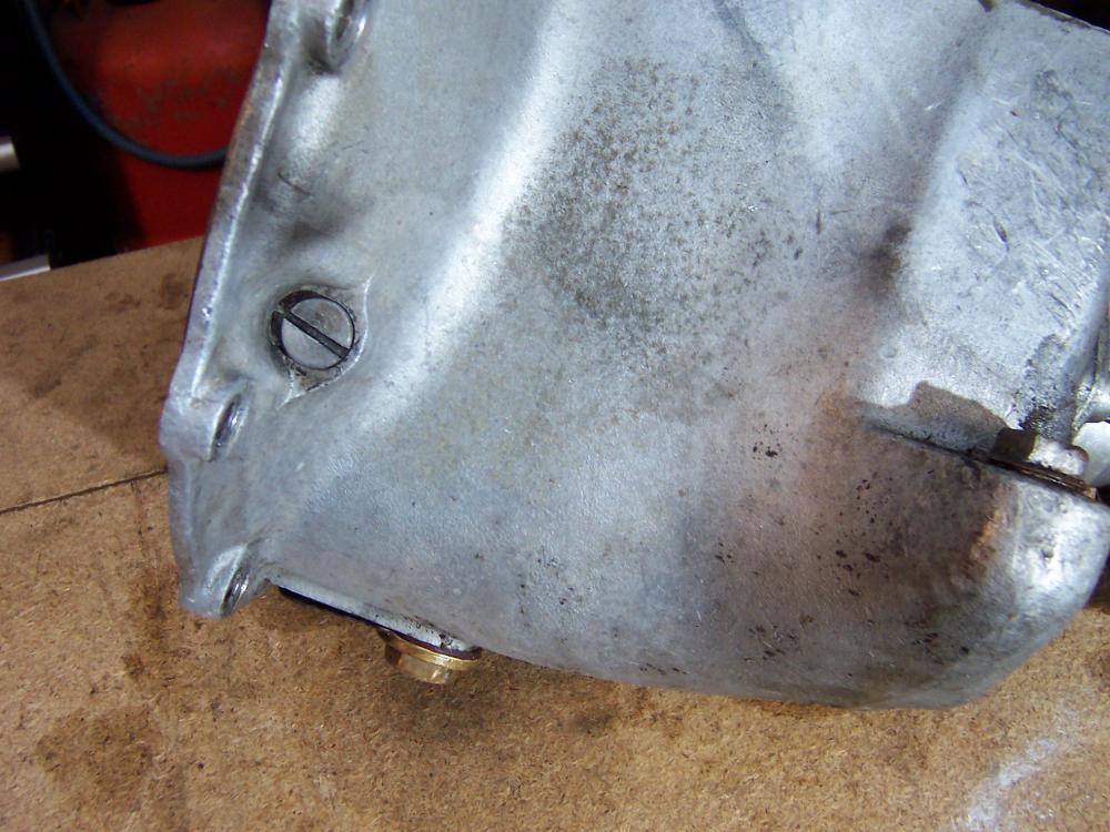

Yesterday I carried out a long overdue modification to the clutch cross shaft, putting a hex head bolt on the end, to make adjustment of the release mechanism easier in a cramped and frequently filthy environment. Couldn't remove the taper pins no matter how hard I tried, so had to do the job with the shaft in situ.
Images show what was involved, and the end result reduces the setting time to a matter of a couple of minutes. Now all you need i a 1/4 BSF spanner to hold it in the right place-proper job! ![]() No, the gearbox isn't cracked (last image)-just a trick of the light
18-08-2021, 12:42 PM
What was wrong with using a right angled screwdriver in the slot? It seems far less trouble.
18-08-2021, 01:50 PM
Alternatively I find you can poke a long screwdriver down the opening for the clutch release bearing oiler and hold the shaft levers forward while rotating the pedal to desired position.
18-08-2021, 02:51 PM
Well, I think it's splendid, well done!
Shame it won't work for the three speed box ![]() |
