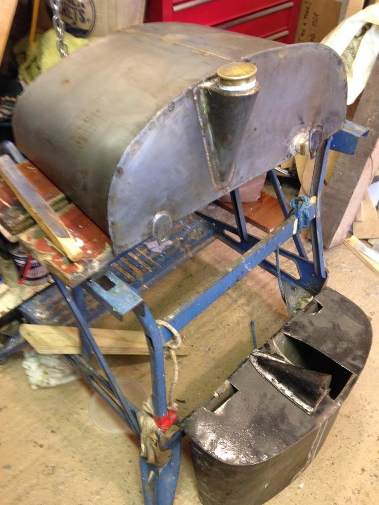

Collected the new scuttle tank intended for the Chummy, pictured above the donor tank the capacity of which had been significantly reduced by foamy goo leak preventing material. So the question is, what should it be painted with?
I would use a two pack high build etch primer followed by two pack black solid colour...I haven’t tried it yet, but the next tank I do I’m going try sloshing the same material inside as well, I’m hoping being two pack it will provide both petrol and corrosion resistance.

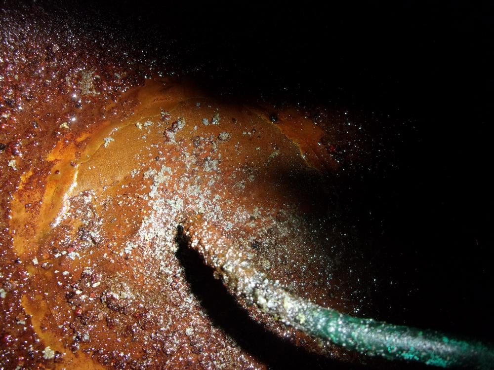

    The tanks off and this is the view through the petrol gauge sender hole, now how to clean it.
Gravel (6mm), water and a cement mixer seems to be favoured but if it's gone thin it might be a bit harsh...
My tank had baffles in it, so the gravel method wouldn't work. I had to have it professionally cleaned and sealed. Cost me £200 but was worth every penny!
