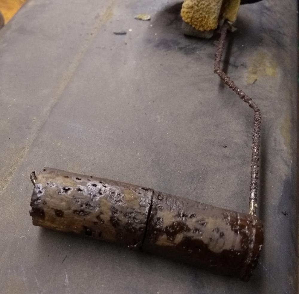

Inside your tank is minging!
(10-02-2018, 06:15 PM)Hedd Jones Wrote: Inside your tank is minging!
More than likely. What I can see which would have covered by fuel is not too bad. It’s what I can’t see should be a concern. I have the gravel, it’s the cement mixer to agitate it all I need now.
