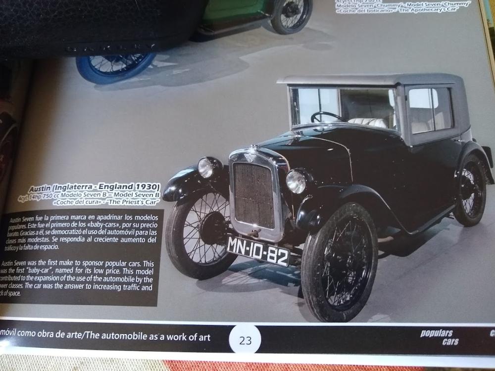

I'm putting up a few photos from one display of various cars in Malaga.
This Rolls Royce shows what can be done with flat panels, even wood, but the compound curves of wheelarches would not be easy.
This shows that a really nice looking seven doesn't have many curves, but again those mudguards/wings would't be easy to make at home. Maybe it is too much like the Highland Coupe.
