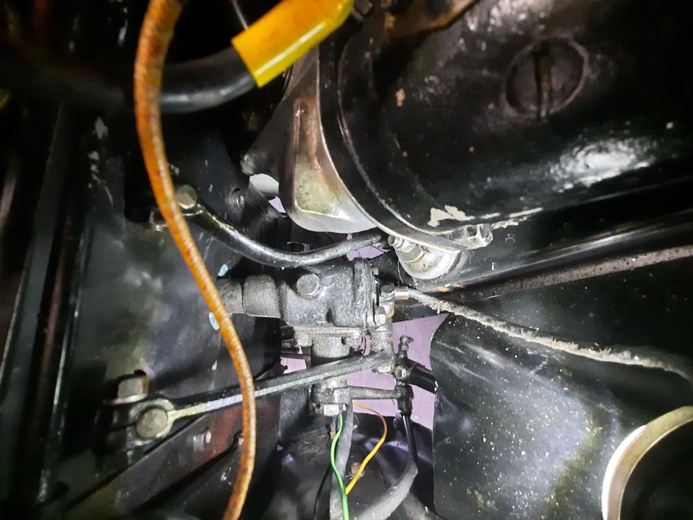

This is the steering box on my 1937 Ruby. Is this what you mean by an hour glass box?
I also have a '37 Ruby with this style steering box & arm- Guidance on where to look for cracks in the arm would be on help please
Yep, that's the "Hour Glass" box, so named because the worm is a complex machined piece that keeps the backlash constant throughout the travel and is shaped like an egg-timer. Fitted from October 1936 at chassis 257866 until the end of production (256501 for export models).
The ones I've seen break were all cracked and broken at the thinnest part of the arm, immediately behind the boss, carrying the ball joint connection to the draglink. Clean the paint off and have a good look, awkward I know. May be worth investing in a penetrant dye crack detection kit (3 aerosols).

Thanks, Parazine for the guidance. Looks like it is only half of an egg-timer, but I will run with your recommendation. Not looking forward to checking for the crack or for removing the arm. Does the arm come away from the shaft easily ? Not much space to work in.
Regards
Graham.
