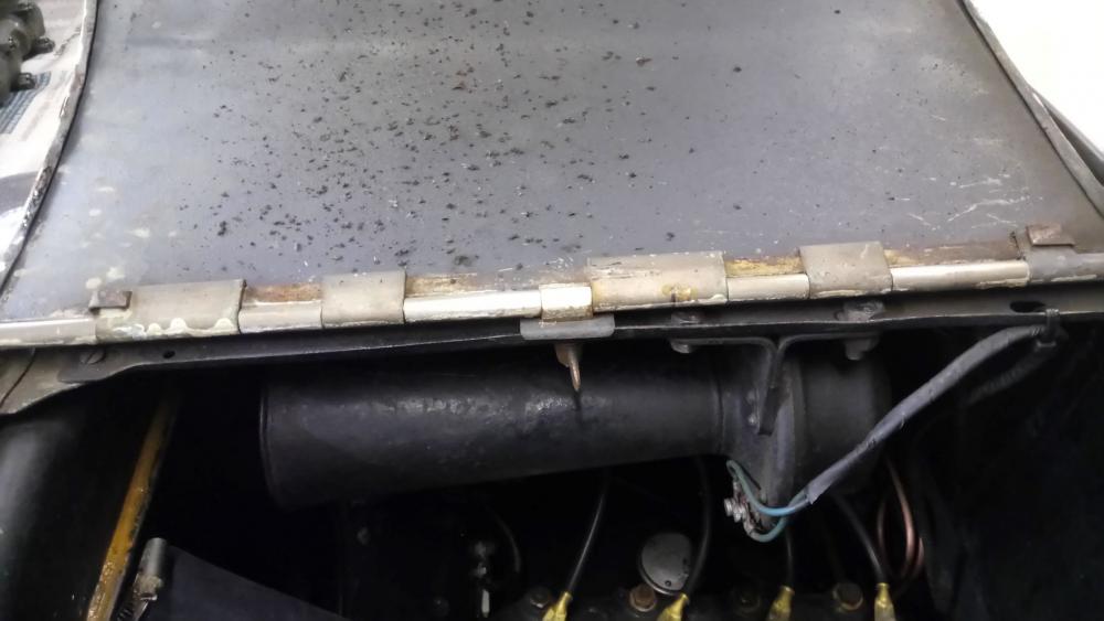

Here's some pictorial evidence at last.
This is the plate spacer from my late '29 RK saloon, a generally very original car so I wouldn't be surprised if this is way Austin did it. BTW, you can see the troublesome tangs here:
Here's the brass spacer I made for my '27 Chummy, it just drops into the U section and supports the special hinge bolt. More tangs to be seen:
And a friend sent me this picture from his Chummy, showing how he got round the vaporising tang problem; a couple of self tappers inserted through the hinge and bonnet:

Some pictures of the hinge, the bar and how the front is sitting too high...trim the rubber seal? Bend the hinge...!
There also seems to be a bit of disagreement as to whether the bar sits under or over the bracket? My rad end bracket has a depression (dished), but the bar has nothing similarly shaped.

Your bar is a cut down item from a later car (the original was about 3/4" wide) so this may help explain the ill fitting of the bonnet.
The rear mounting method was originally to put the end of the bar, which is flattened, into a clip, spot welded onto the scuttle with no securing screw. You can't see the clip on my photo's but I'll try and add one later. At the front, the bar was fixed with a 3/16" screw and nut to the rad bracket (Usually 2BA or 5mm is used these days). I'm sure it fits on top of the rad shell bracket. Fixed in this way, it floated longitudinally.
And your friend's bar appears to have the flanges down, not up....!
