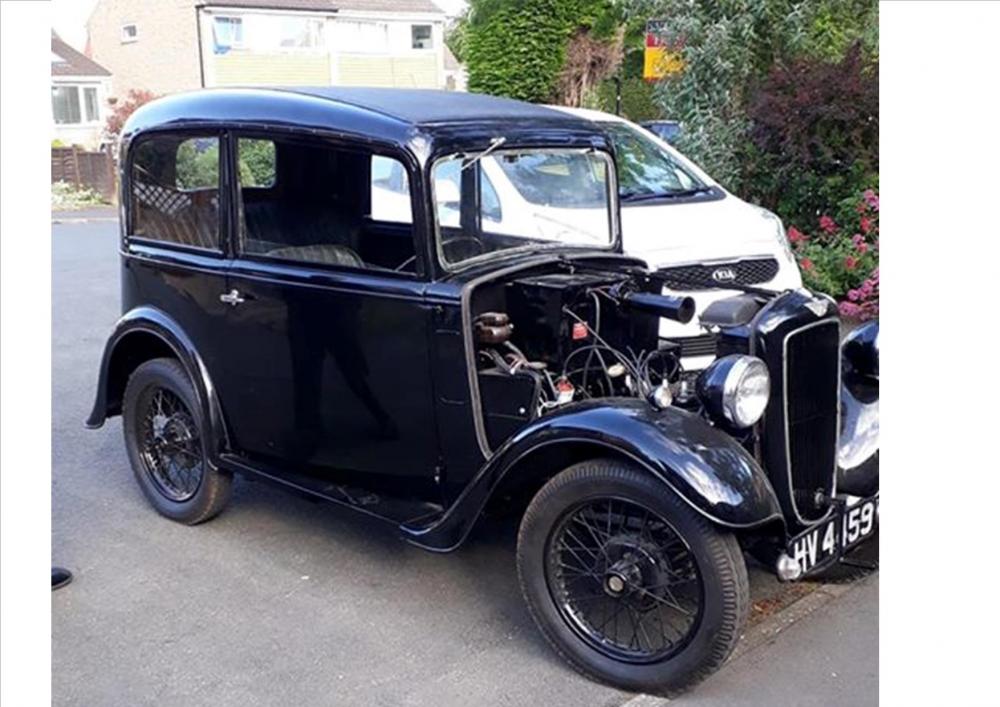

Took the Ruby for it's first drive. About 5 miles.
First time it's been driven since 1967.
First time I have ever driven a seven.
Wonderful.   Congratulations .
Do you want to repeat the experience, I wonder?
Yes Simon, I do want to drive it again! Mostly it was enjoyable. Engine seems to like to rev, which isn't my usual driving style, but it can be. Steering is wonderfully quirky, and I've always enjoyed driving with no brakes, so all is good. Gear ratios seem odd. Anything less than 32 mph and it needs 3rd gear. Setting off from rest on the level and first gear seems too low, but second seems too high. But yes it's good and the human mind soon adapts to these things.
(25-05-2020, 09:35 PM)andrew34ruby Wrote: Yes Simon, I do want to drive it again!  Mostly it was enjoyable. Engine seems to like to rev, which isn't my usual driving style, but it can be. Steering is wonderfully quirky, and I've always enjoyed driving with no brakes, so all is good. Gear ratios seem odd. Anything less than 32 mph and it needs 3rd gear. Setting off from rest on the level and first gear seems too low, but second seems too high. But yes it's good and the human mind soon adapts to these things.
Very well done - that must have been a most interesting experience. Many cars of the 1930s with a 4-speed 'box had a very low first gear; it saved the previous situation, with a 3-speed 'box, of having to go up very steep hills in reverse - and I'm not kidding!
Well done Andrew! It is probably 50 years since I drove an ARQ Ruby. The example I drove belonged to friend who had owned it from new. It had done about 60,000 miles  and was a very civilised little car indeed.
If it won't run properly in top at less than 30mph, you may have to do some running adjustments. Mechanically, your car will be very similar to my RP saloon and should pull in top from about 20mph (the RP handbook urges one not to drive in top below 18mph!). Whilst I accept that, with the early crash box, my RP is lower geared in the indirects than your Ruby and the Ruby is also slightly heavier, you should be able to pull away in most situations in second without difficulty. AS Tony Griffiths has said, bottom is really an emergency low gear.
Good luck with your little car!
