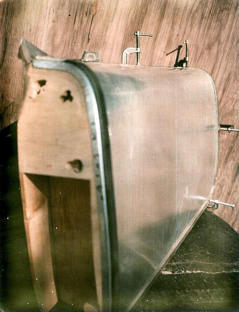

Yes Peter I do have to anneal the aluminium, once during the beating stage and twice just around the edges whilst wiring them. Its is a good thing if the aluminium work harden's a little in the middle of the wing as you finish the planishing as it make them tougher and less inclined to dent from stones that may get thrown up in use.
