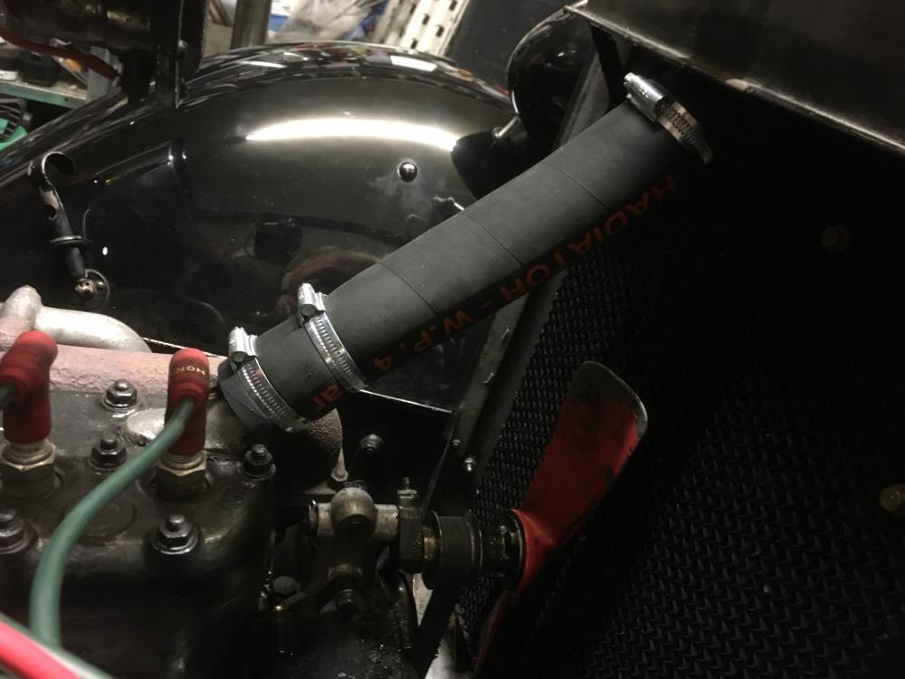

The hose I used is 42mm ID and the stat is a snug fit
I've included a photo of the finished job now I've fathomed out how to transfer photos from mu phone, hope this helps

I though I'd cracked sending a photo but had to go back to the drawing board !

That looks very good.
I think you have a bit more clearance under the header tank than I have. Allows a single size hose to be used.

Is it possible to use another piece of inner hose to locate the thermostat, and perhaps take this up tp the top clamp.
Then the third clamp is not needed.
Peter

Thanks for the compliment and, more importantly, floating the concept in the first place

Probably, but most engine manufacturers site the thermostat very close to the cylinder head, presumably this was the best place to monitor the temperature of the engine. Certainly in the 'good old days' it was always inside the water outlet of the head. I actually made it that the sensor of the stat was partially in the aluminium outlet. If it was at the top it might not be as sensitive as it should be and open correctly, but that's only my personal opinion for what it's worth.
Sorry - forgot to mention that my local factor supplied me with half metre for about £10 = the stat was about a fiver from ebay. and a couple of quid for the jubilee clips, so the whole job came in under £20. I also run anti freeze all of the time which has stopped the corrosion in the engine
