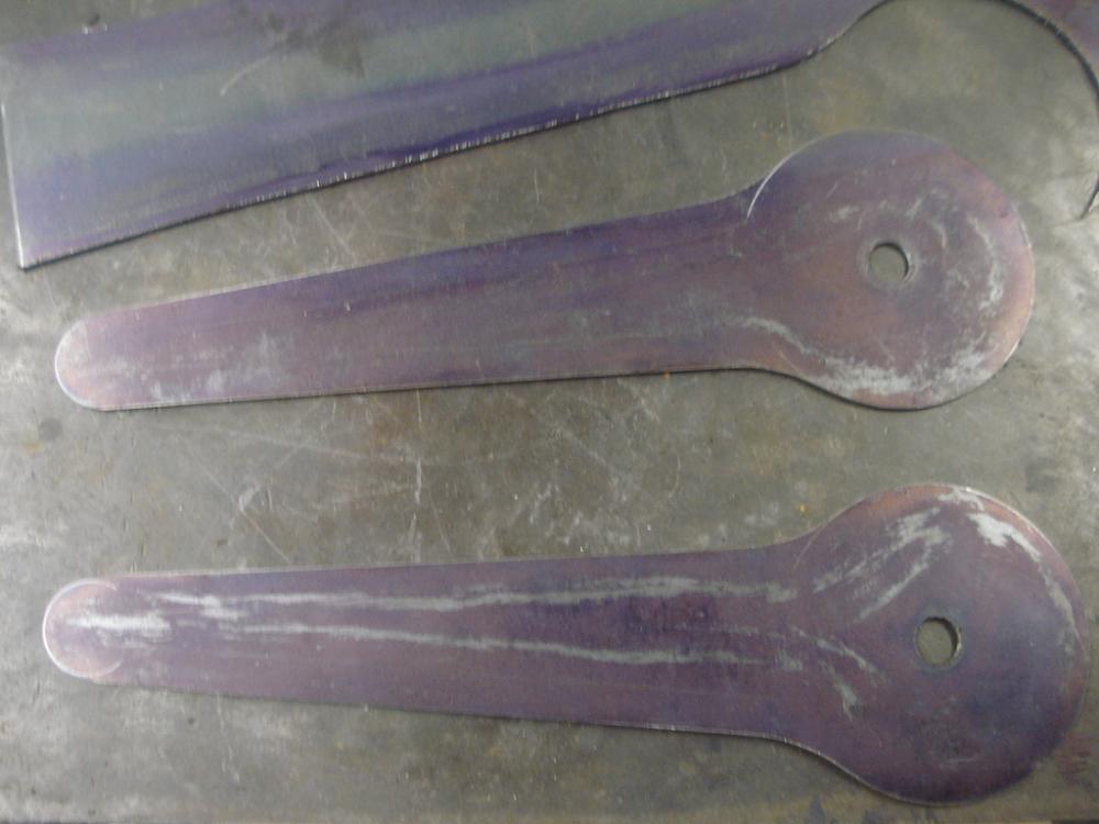

Update, the past few days I have be busy remaking my front damper to fit the revised axle arrangement, this entailed making new shorter arms and adding a further fixed and moving arm to the assembly, the pictures should tell the tale better than words.
Very nice, Ian.
What type of steel did you use for the arms?  Originals seem to be a type of spring steel.
I have to make a pair of rears for a Bantam.
Cheers,
Peter
Bright Cold rolled because I had it in stock, but yes I agree that originals were a higher carbon because they harden where spot welded. the outer arms of my set up are shortened originals, the centre arms and the additional fixed arms are the ones I made from scratch. The Main bracket is one I made from 1/4" mild steel 30 years ago and which I salvaged from the original car.

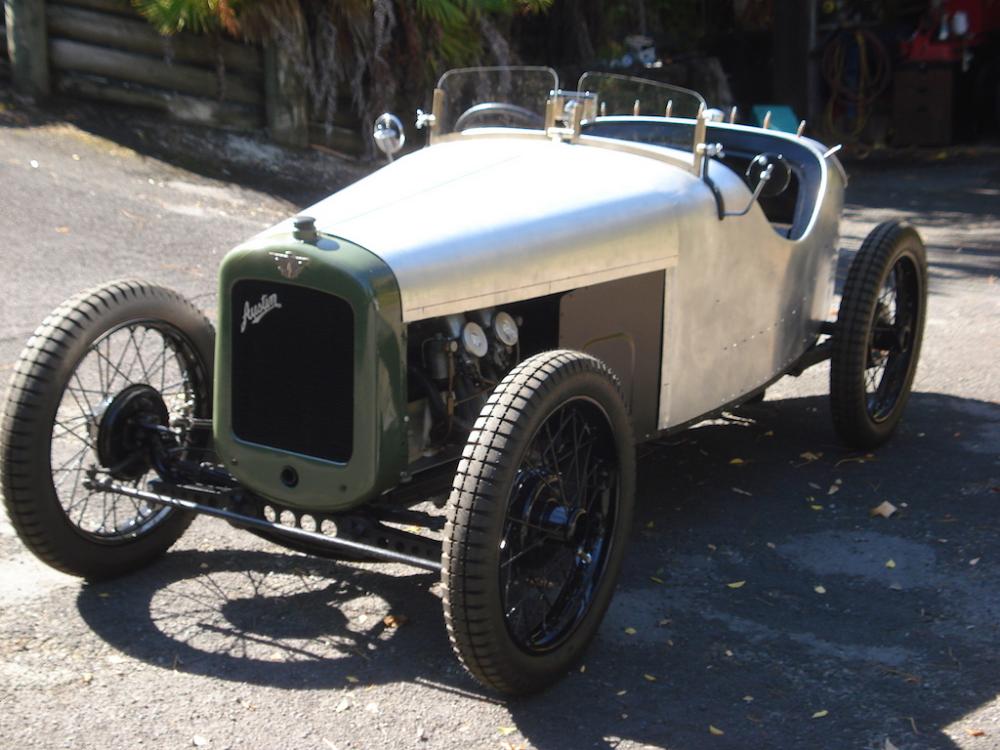

Past few days I have made some mirror arms and experimented with some perspex to determine the windscreen glass shape.
No comment Ian because this is a matter of taste of course.
Yours is good enough for me!

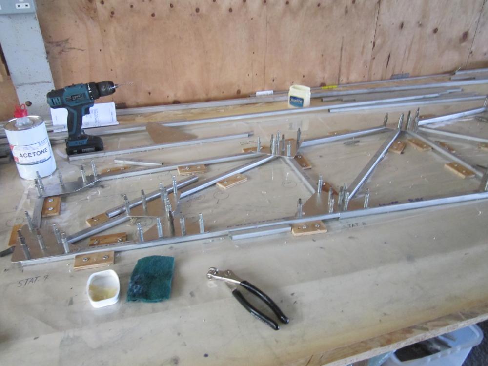

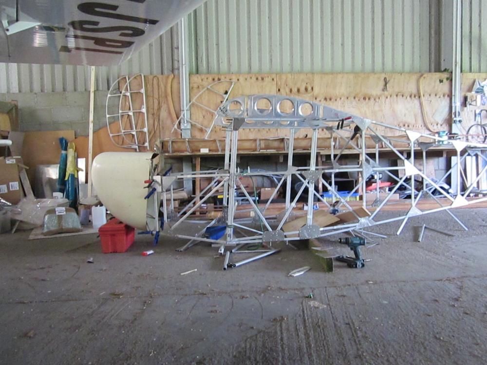

When It comes to 'Skin-pins' or Clecoes, you won't use more than my other project, several hundred 3/32" before drilling and riveting 1/8th".
make building a Special body look easy !!! :-)
OK Flywheel,
Firstly what is it and what engine does it use?
Secondly, I presume all the joints are riveted but am intrigued as to the tub of vaseline?
Also as the struts are tubes how do you deburr the inside of the rivet hole drillings?
and finally what grade/type of rivet are you going to use?
Well you did post a photo!!!!!!
