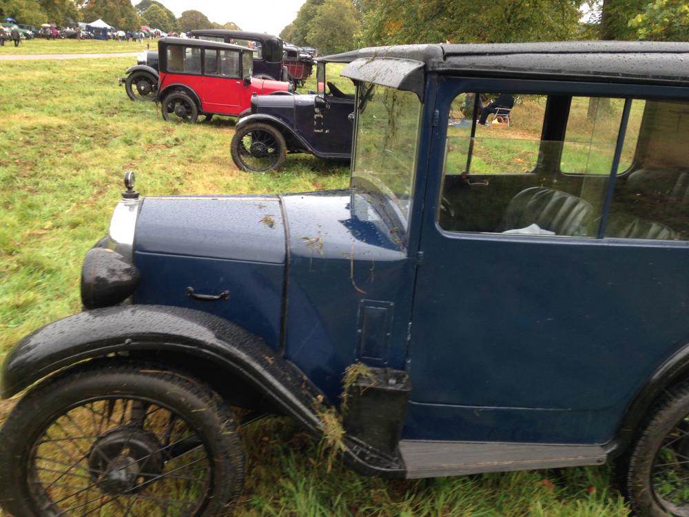

The scale in that shot makes the Ruby look enormous!

A slightly random selection of Sevens spotted at Madresfield this afternoon, when the downpours actually eased off.

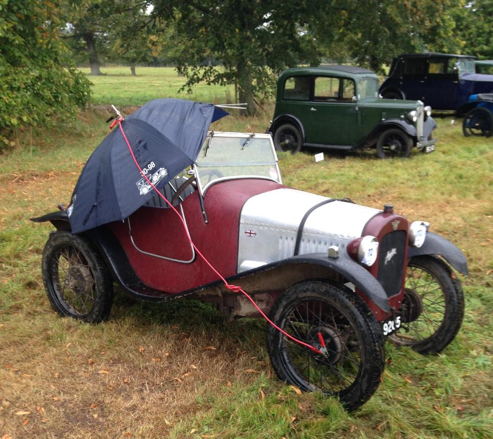

A Gordon England possibly attempting battery charging derived from heavy rainfall, or possibly not.
Is that your Ruby behind the Gordon England Cup?
My 1931 RN was At Madresfield. Hiding behind the 1926 Chummy.

David, it was indeed the Ruby of Govilon behind the Gordon England rain generator. I know that several distinguished Forumists like to use their Leicas, Hasselblads or maybe have the tripod for the Gandolfi strapped to the luggage rack, but the ability of our phones to generate images of that size is remarkable. The rain had almost stopped but it was certainly not bright. The foliage in the background around Roland's saloon is a bit blurred and the Ruby less than sharp but the pictures are really quite remarkable. Now, modern motor cars such as the 2CV have what used to be a cigarette lighter, into which to plug the charger that keeps the mobile smart phone charged up for a long day's photography or ringing home to warn of late return and request wine ready in the fridge. Is there a 6 volt version of this to install in a Seven? What do electronically savvy members do?
