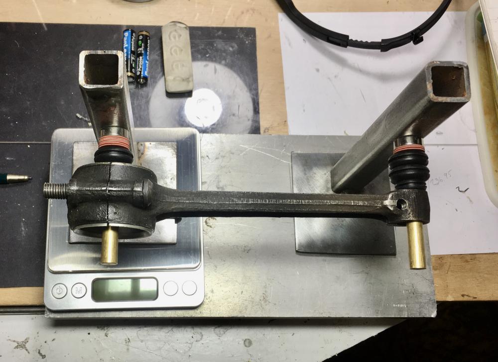

Parts of the conrod weighing jig I’m busy with after perusing many designs on YouTube, and eventually coming up with these parts for my own take.

Everything made for the jig as in photo, just need a few minutes with slitting disk then a few MIG tacks and done.
Did so this afternoon but one of my tacks didn’t survive a tug test Sad
A couple of additions became apparent when using it, they to be revealed in a video once done.

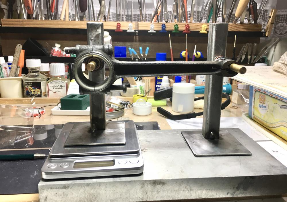

Weighing jigs done, but work in progress.
The two brass rods have neodymium magnets screwed onto the ends thus making height adjustments easy and one has a roller bearing for the big ends to rest on, whilst other end on the brass rod.
The first problem reared its head when the magnets where very quick in attracting the rod, hence the rubber spacers.
