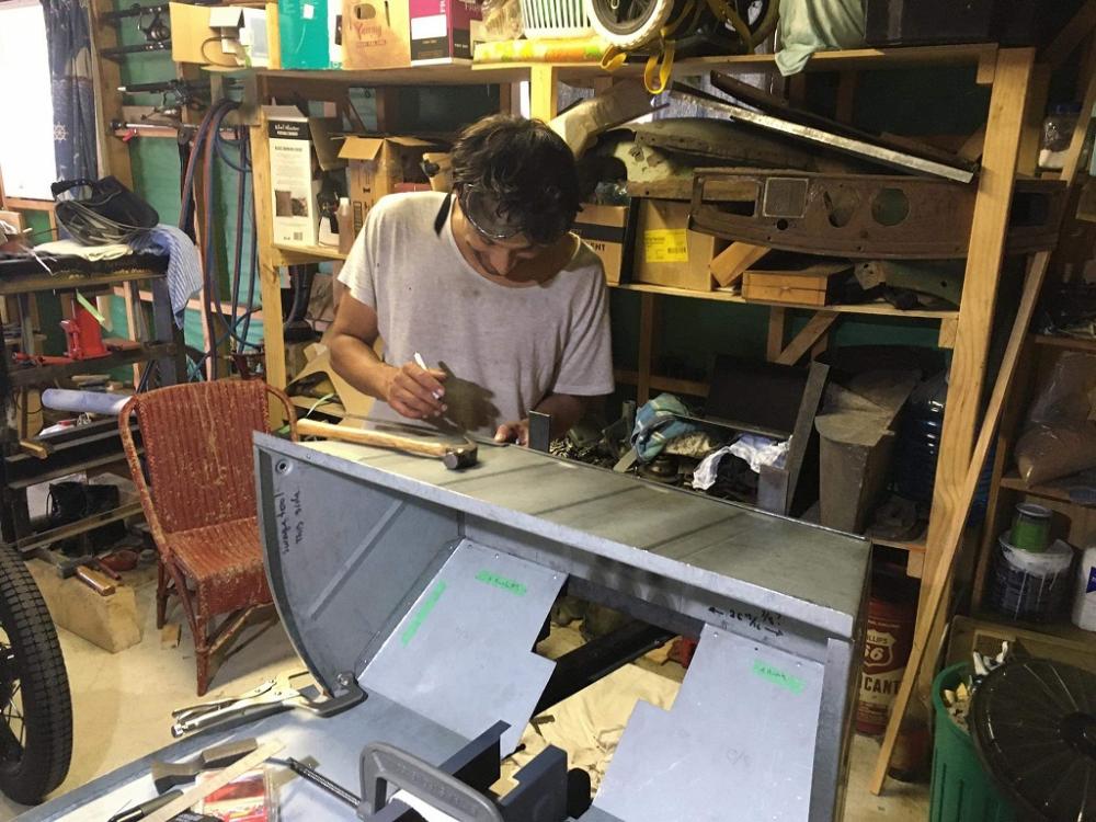

Since the last update I have been grappling with the rear section of tunnel over the Diff. This has proved quite challenging for me and resulted in a lot of trials and tribulations. However perseverance paid off and after 5 attempts including two 3/4 scale versions, success was had. Below are few pictures of the drama.
