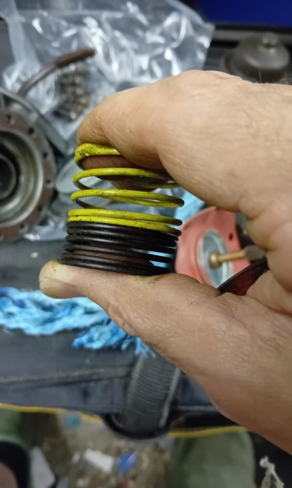

 Now there's been a fair bit of chat about the strength of springs, so I thought I'd try to compare the yellow painted spring in the new pump with an old one from a pump that failed previously due to leaky valves.
The yellow one looked a bit thicker but felt the same, so I started to think how to test both to see if the spring constant was the actually the same. I thought about weights and measuring heights, but quickly realised there's an easy approach to most things...
