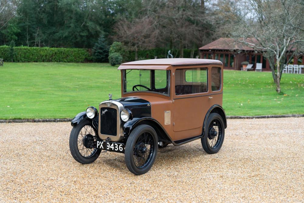

My collection grows slowly... Big Grin
The most recent addition is an RF Saloon, built in 1928 and registered first on 10th January 1929. I will travel to England and pick the car up around Christmas time. I'm looking happily forward!  Wink
Some of you guys may know the car.
Absolutely beautiful, I’m quite envious!
