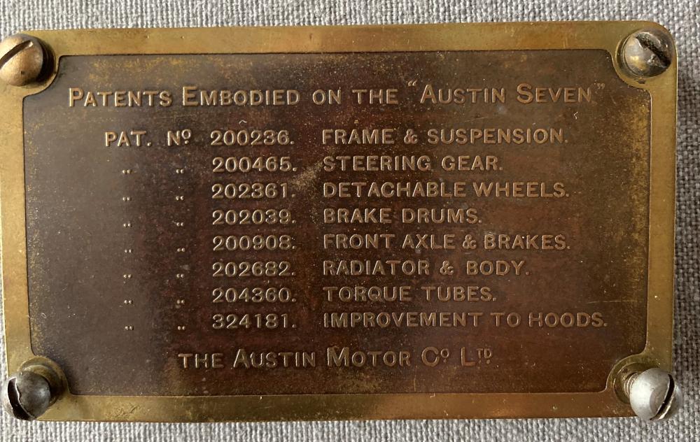

Catching up -
Your earlier post of the Patent Plate finally identified the mystery plate I had as a Big Seven variety. Excellent - that was bugging me...

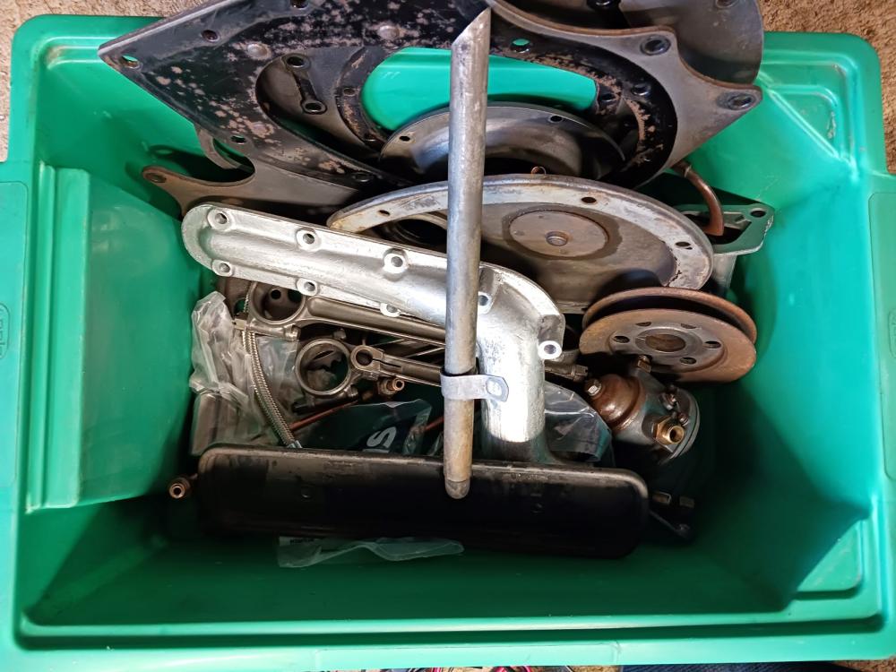

It took an interminably long time to find the necessary spares for this engine build. A set of +20 pistons came from Scotland after a chance meeting at the centenary, Tony Betts was able to find some shells and valves, thanks Tony. The Big 7 register was able to supply some new parts but Robin has been in poor health for that last year or so the spares scheme has been operating very slowly.
However, just before Christmas, the block and crankshaft were dispatched to the machine shop and I had word today that they should be finished next week. In the meantime, I have been cleaning:
I also had to machine the water side branch, which the Register were able to supply but in unmachined format.
I have also made most of the gaskets, the Register has a few but not enough to rebuild an engine:

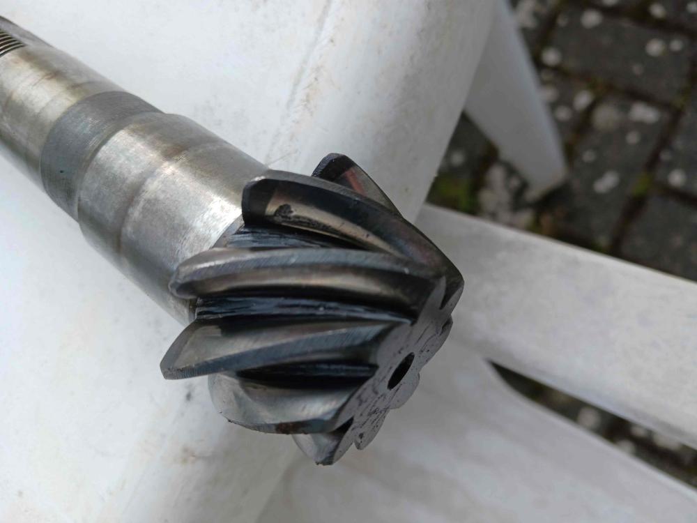

Yesterday, I started and ran the engine for the first time, sounds nice and smooth. Took the car out for a few short test runs, all OK but the back axle has a horrible growl on drive, quiet on overrun.
I suspected that I would find endfloat in the pinion shaft and I wasn't disappointed. About 3/8"  Dodgy
Pulled the torque tube out and dismantled it today. Input flange was loose on taper, spacer was very worn, the nut was still tabbed up from the factory but the spacer measure 1.095" and it should be 1.125"!
Sadly, the car must have done a few miles in this state as the pinion has picked up at the back end where it was being wound into mesh too deeply.

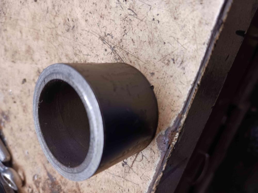

I'm making a new spacer from a piece of scrap steel, I'll put it together and see how it sounds but it ain't gonna be quiet!
I think that I read somewhere that the spacer is best made from 4140 high tensile steel or similar.
From my notes the Big 7 Pinion thrust was a high capacity split outer ring double row ball bearing (R&M 3 MDJT 25) which is unlikely to be available now but a standard double row ball bearing (SKF 3305A) will fit and with the later design and limited use should be alright.
(24-05-2023, 11:47 PM)Tony Press Wrote: From my notes the Big 7 Pinion thrust was a high capacity split outer ring double row ball bearing (R&M 3 MDJT 25) which is unlikely to be available now but a standard double row ball bearing (SKF 3305A) will fit and with the later design and limited use should be alright.
Apparently R&M 3/MDJT25 is still available from Simply Bearings here in the UK - expensive though at £62 + VAT.
