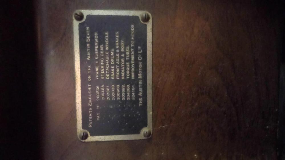

That is beautiful. Does it perchance have a riveted dash plate, or set screws?

The patent plate is screwed on - looks original to me.

Interesting that the patent plate mentions a patent for detachable wheels.  Presumably this is the elongated holes in normal A7 wheels that allow them to be removed without fully removing the wheel nuts?  Strange in that the Big 7 had ordinary steel wheels with normal holes.   It is almost as if Austin thought that there needed to be a patent plate on the dash yet didn't have any patents for the Big 7.   Were they simply using up the ARR Ruby patent plates?
Perhaps this post should be in Patent Plate Minutia!

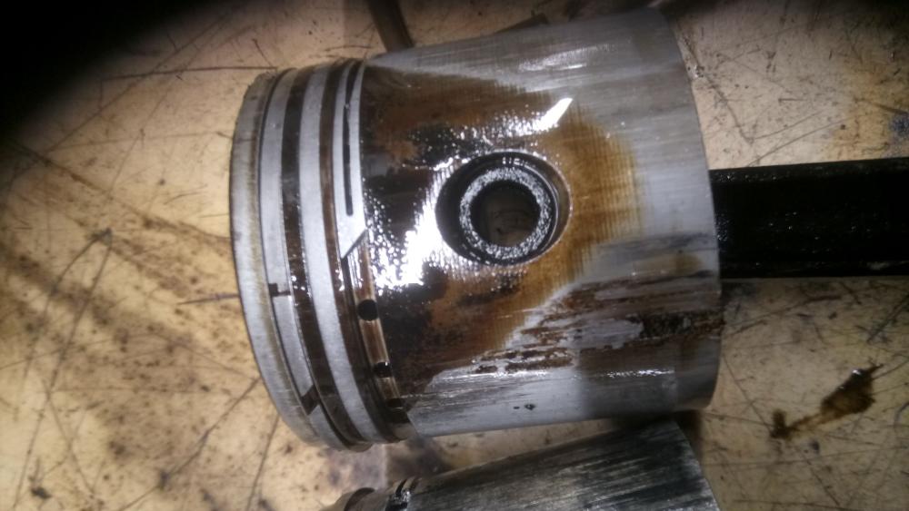

The reason for all the smoke and oil fouled plugs?
All four pistons had the top compression ring and the oil scraper ring broken. All exactly the same. What on earth caused that? The pistons appear to have picked up too so maybe the engine was overheated, causing a seizure?
Must have happened recently in the cars history as the oil fouling inside the combustion chamber can be cleaned off, revealing normal deposits.

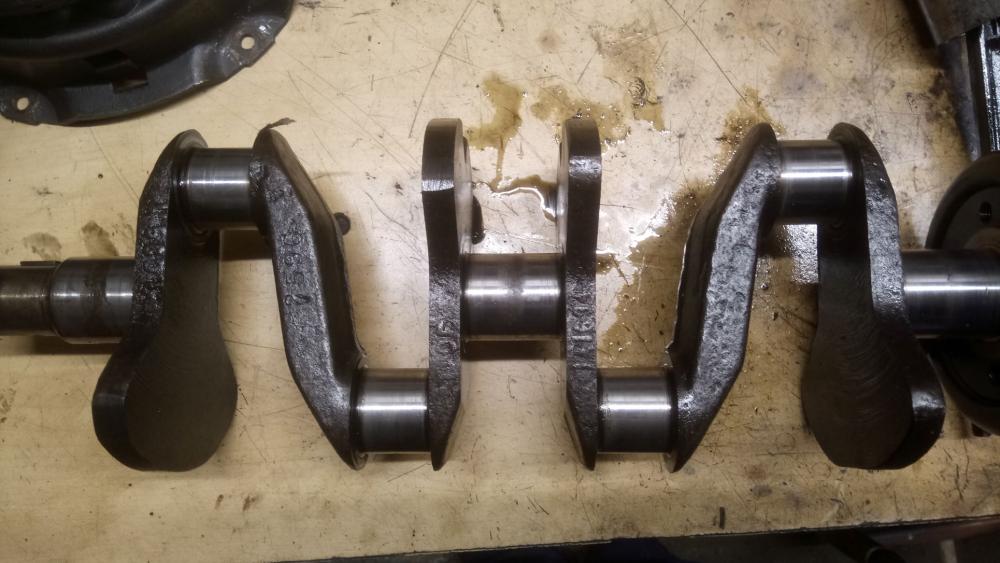

Crankshaft appears OK, centre main is about 1/2 thou oval, all the other bearings are on size. Fair bit of rust pitting however but should polish out -  I hope.
I have to own up to breaking teeth off the crankshaft chain drive sprocket though  Blush
I think that you're supposed to undo the sprocket on the camshaft, then push the camshaft backwards to free the chain from the sprockets, not try and remove the sprocket from the crankshaft, where it is positioned with a punch mark.     Hindsight - 20/20 vision......
