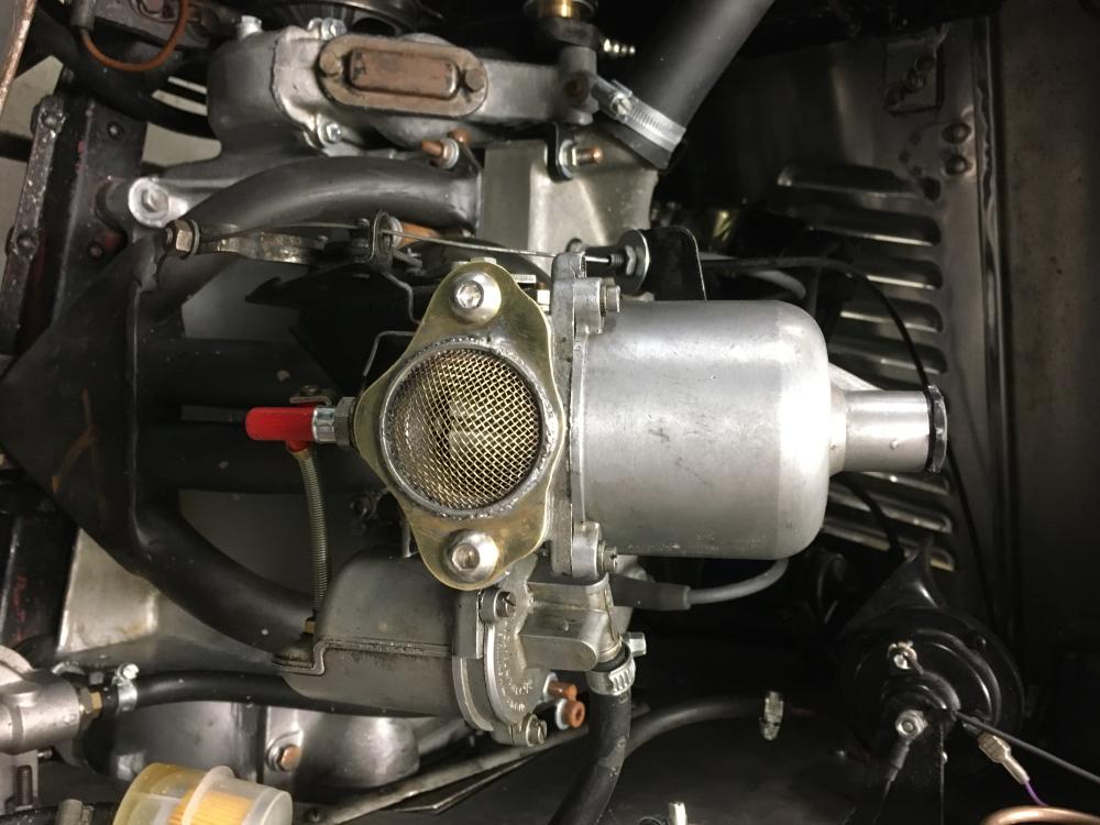

I'd be tempted to fit a mesh screen to the carb inlet, it's a big hole and will suck in all sorts of flying crap...
You have a mesh screen design proposal? The Zenith had an export air filter, the spacer block allowing the SU to bolt on to the inlet takes up too much space to allow the attachment of a pancake. I'd like to see examples of  possible filters.
Something like this? I've made several for Austins with SU carbs...the depth of the raised screen is about 10mm off the face of the carb flange. The pic needs to be rotated anticlockwise by 90* but I can't seem to achieve that...
