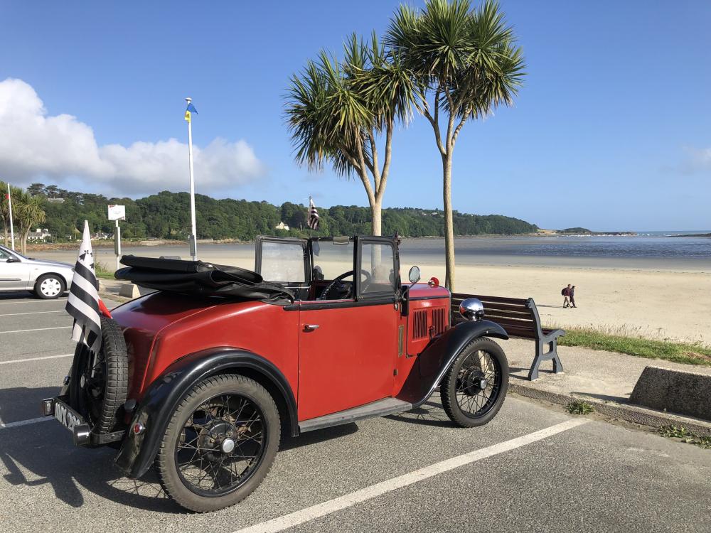

            Well Poppy and I are in Brittany. We have been to the ABVA tour de Bretagne at Carnac, driven back to the house in Treduder . Done a road trip around the Bretagne coast to Morlaix and back. Traveled to Tregoir and we are popping down to Guerec for a meeting in the village tomorrow.
Pastis and an Austin Seven in France, magnifique!
