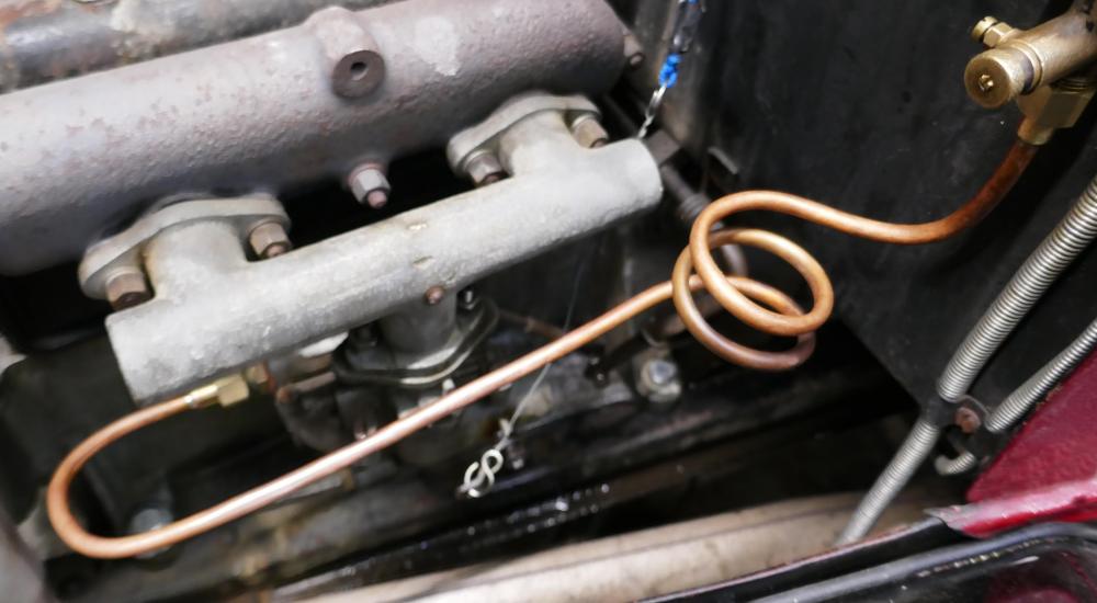

Thought that I'd better fix the "as received" rigid fuel pipe and make one with anti-vibration coils. As this was the first I've ever had to make, it took a while but appears to have turned out OK.
