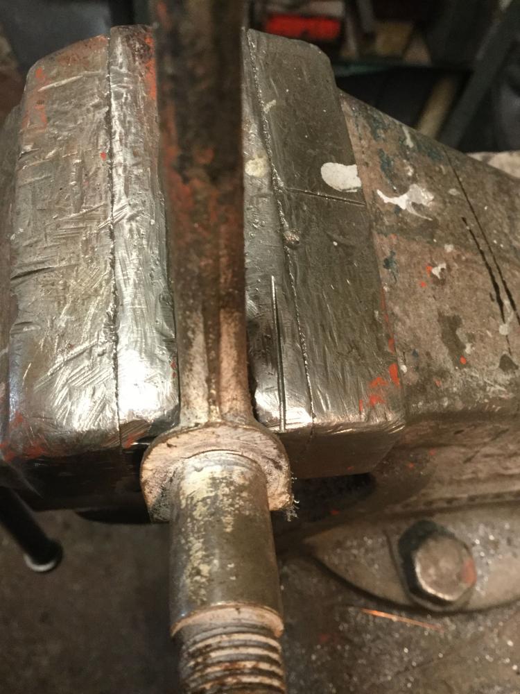

    This is an arm showing cracks on internal spigot radius. Not easily spotted without taking off the car

Dave,
are you prepared to destroy (snap) it and report back please?
#88
R,
I can have a go but my 4” vice may be the first to break!
Cheers,
Dave.
#89
Thanks Dave,
I have a good number here but none show any cracks, otherwise I would do it myself.
#90
R,
Just had a go at trying to propagate the crack in the corner rad in the spigot using a 4 ft scaffold pole.Succeeded in bending the arm over its length by 10 deg but no alteration in crack size. Also managed to move my bench by 2ft. Arm going in scrap bin. Dave
