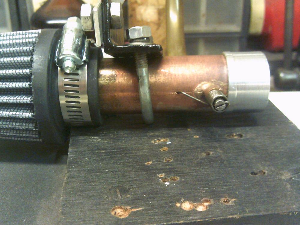

Dave - I see your fuel pipe coil is in the vertical, but tell us more about what you have done to your carburettor. Oil breather and filter on the air intake and have you added a choke butterfly ?

The intake pipe has a hose to the valve chest cover for crankcase ventilation and a choke flap which uses the original disabled choke flap spring.
