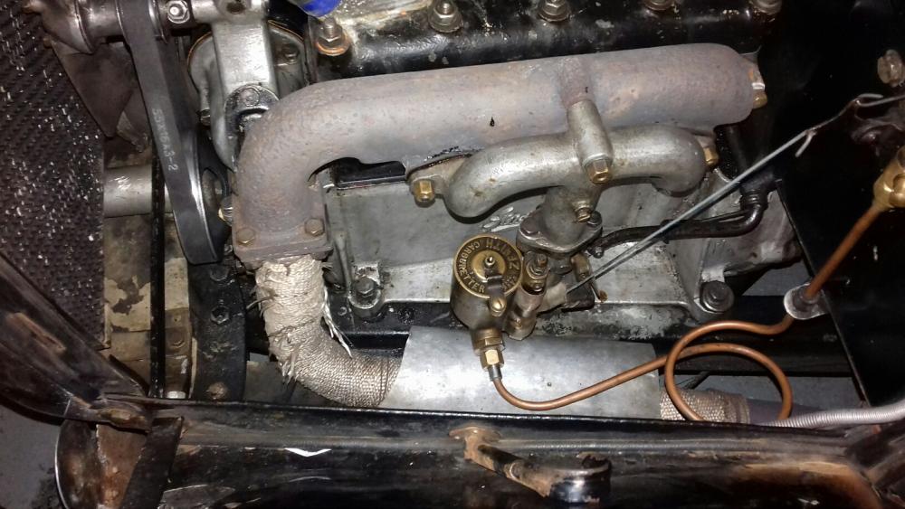

I think Recks is right, you need the hot air to escape somehow. Failing that, the exhaust must surely be the biggest contributor. Have you tried binding it in exhaust wrap? (eBay) That might shave a few degrees off and looks quite 'period'.

My 1929 Fabric Saloon has the exhaust downpipe wrapped and an aluminium heat shield between the updraught carburetor and exhaust.
There are no ventilation holes in the bonnet and I have had no vapourisation problems in use.

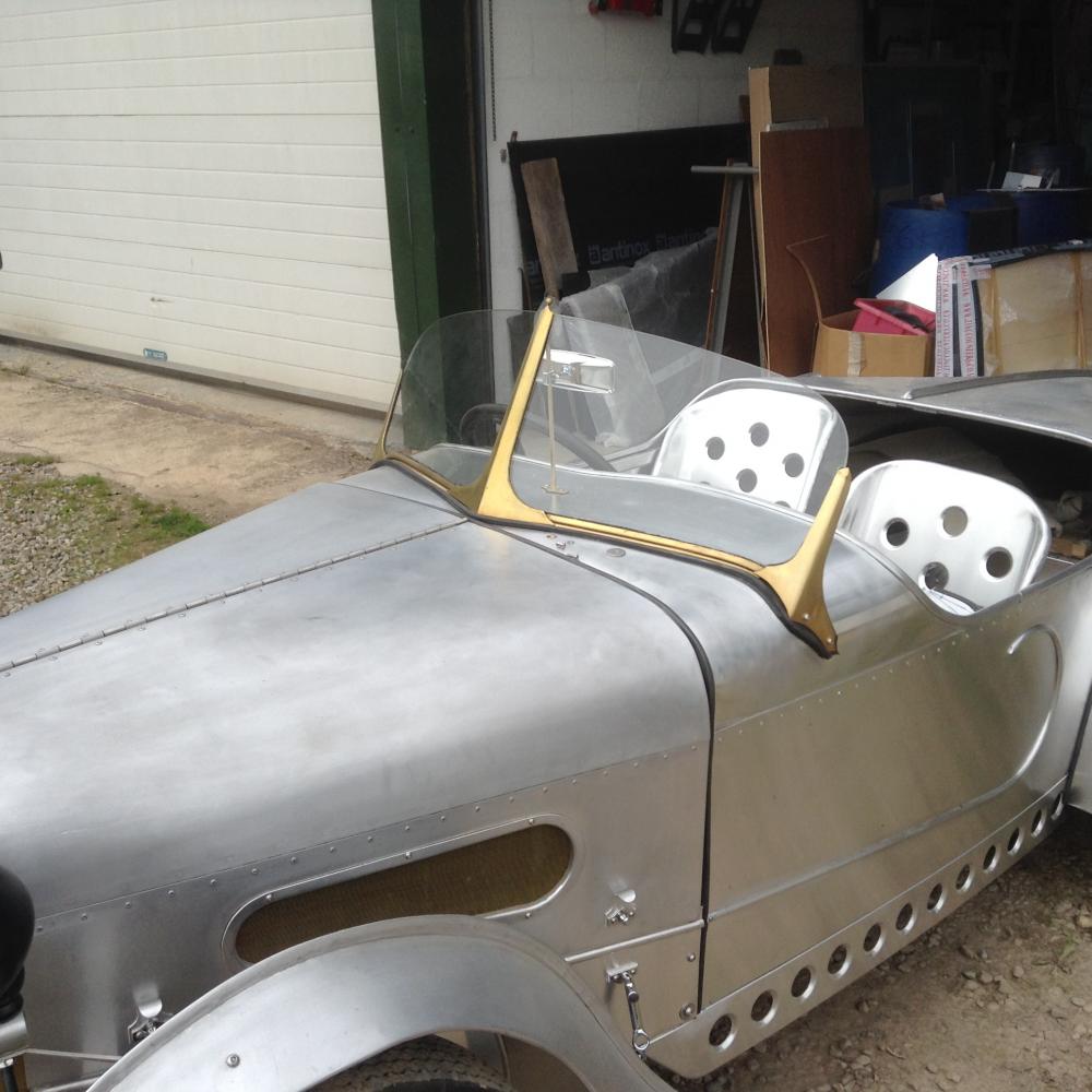

Duncan,
Your special looks superb. Would you be able to post a few more photos?
