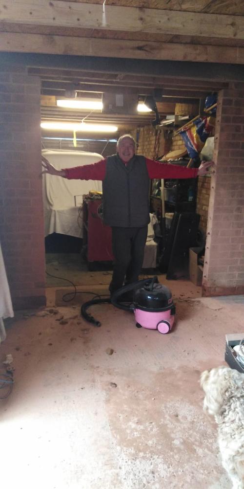

.jpg   IMG_0037.jpg (Size: 22.01 KB / Downloads: 285) Just taken the back wall of my garage out so the Ruby (under white dust cover), can be pushed into my "Campbell Shed" themed extension & finished off and be ready as a 'Daily driver' by Easter !!!!!
