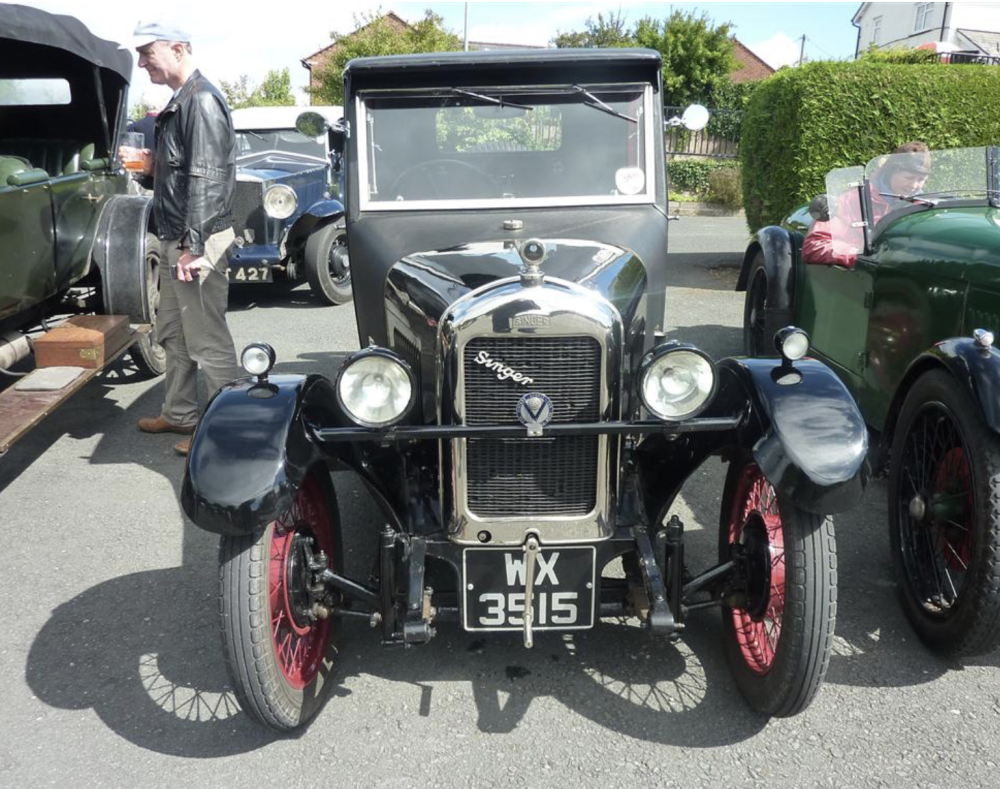

Careful now, in case vengeance drones are sent out to chase you, launched from a car park in Hockley Heath. Remind me of the front suspension on the Crouch Helix just visible in the picture, a car always to be seen as pre 1930 eligible on the VSCC Welsh Trial? Mind you, it is owned by well known and respected Singer specialist Keith Hill..... PS, a pal who has a very original early Chummy, 6" brakes and no shocks, say only hairdressers have shock absorbers. Or he will when we have pulled him out of the hedge.
