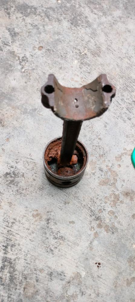

Old/brown/rusted connecting is currently removed from my engine (Not in a useable condition)

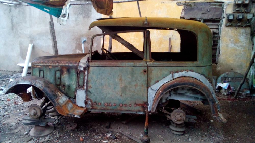

Polished/good condition (6 Pieces) - Evaluating it for buying - Please guide is this suitable for my car (attached my mk1 model photo)

I do wonder what the state of the crankshaft is like given the condition of the big end shown. The two components (big ends and big end journals on the crank) need to be in perfect condition. My apologies if this is already understood...
