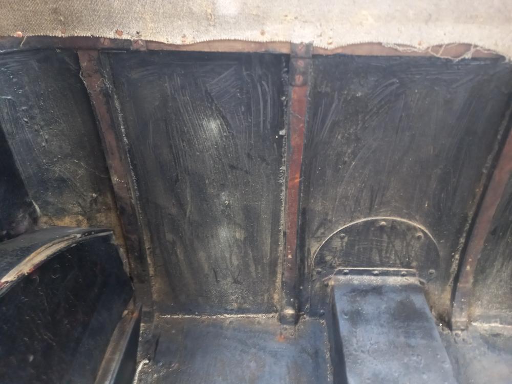

My March 1930 RK has three uprights across this area.  Mind you whether these are original is anyone’s guess although they do look to be.
Here is a very poor photo.  Car is in the garage and it’s too cold to wheel it out just now.  If you want I can take a better snap later today  Wink.
.jpeg   64D0CB7B-DBF2-41EF-94D6-7F0BDCC2E6E9.jpeg (Size: 88.74 KB / Downloads: 365)
Many thanks Howard.
Interesting, I was hoping, or even expecting, to see four on an RK!
A better photo would assist further please.
Both my RKs (early 1929 and mid 1930) had that central timber going through the spare-wheel mounting, so presumably three in total. I have a photo of the 1929 car on which it is just visible, but doesn't show up on a scan of the print.
Hi Chris
This photo is better.
Quite pleasant in the sunshine now!
.jpeg   101E61D0-6188-429B-875E-B607DE429E7B.jpeg (Size: 123.56 KB / Downloads: 314)

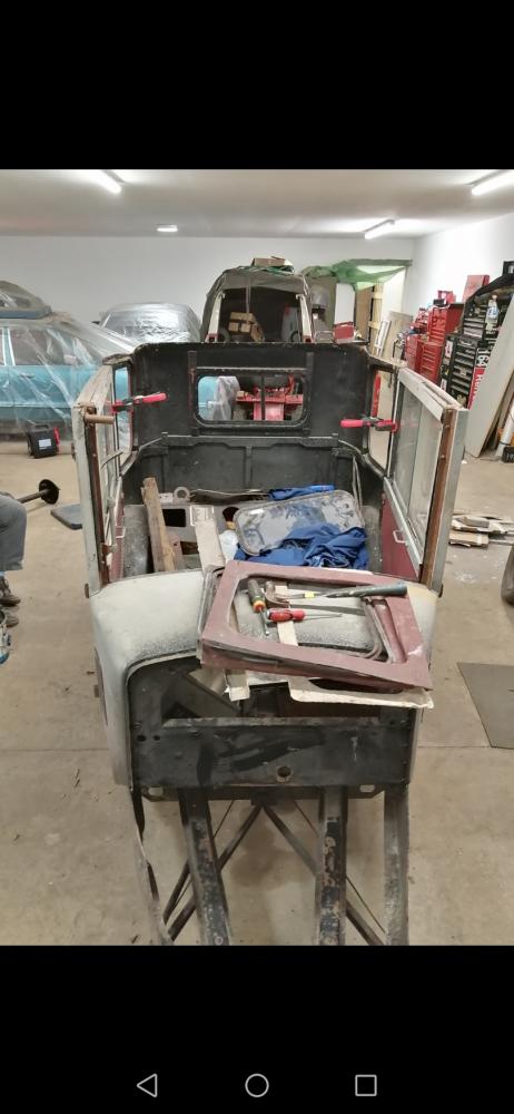

Here is a photo of my 1929 RK while i was installing a new roof structure.

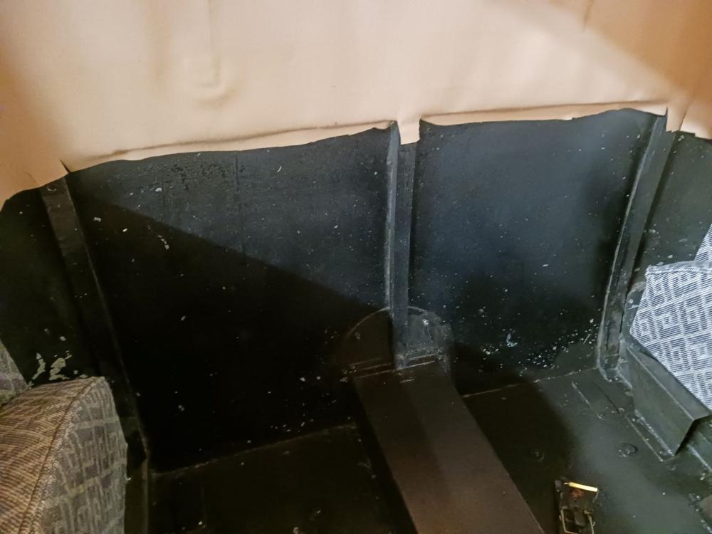

My February built March registered RK has the three frame pieces
Thanks everyone. This is the view of my late R showing the arrangement of the uprights - two either side of the transmission tunnel.
It's beginning to look that this interim model had this unique feature in the body structure, one I knew nothing about.

Here is my "R" saloon, manufactured late 1926. Clearly three pieces of wood.
Thanks, by the way, I went out to the garage to take this photo and discovered that a mouse had set up shop under the back seat, hence the loaded mousetrap!
