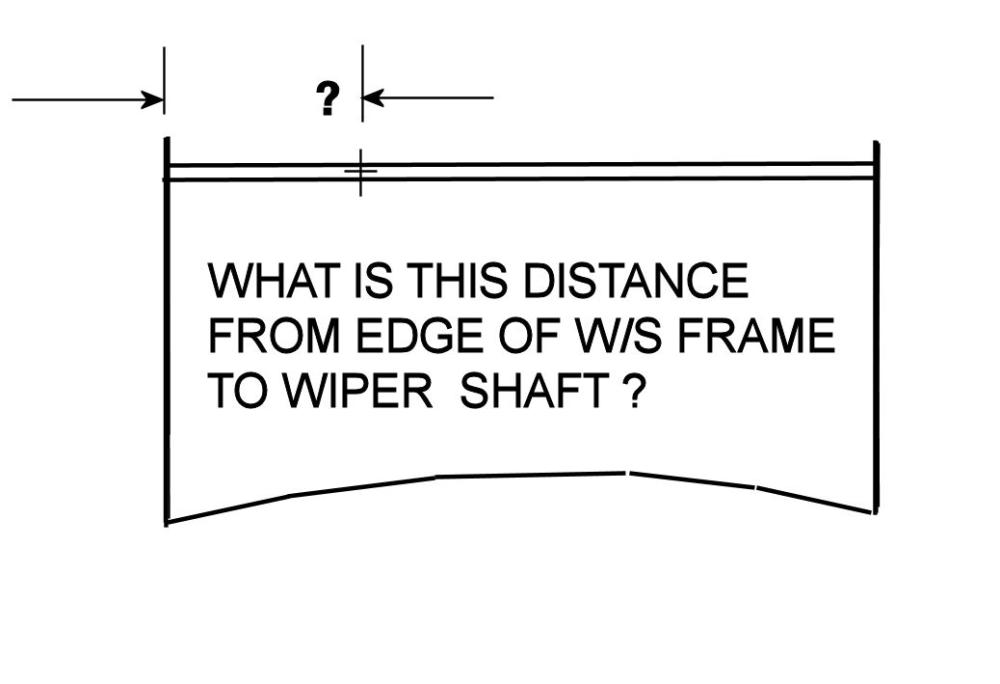

Hi, can anyone tell me the distance from the edge of the windshield frame to the shaft of the windshield vacuum wiper motor on a AD windshield please?
I need to drill the holes for the motor on the frame and have nothing to guide me. Thanks.
Stephen
Sorry, haven't got an AD on the premises - perhaps you might ratio/scale from this photo?

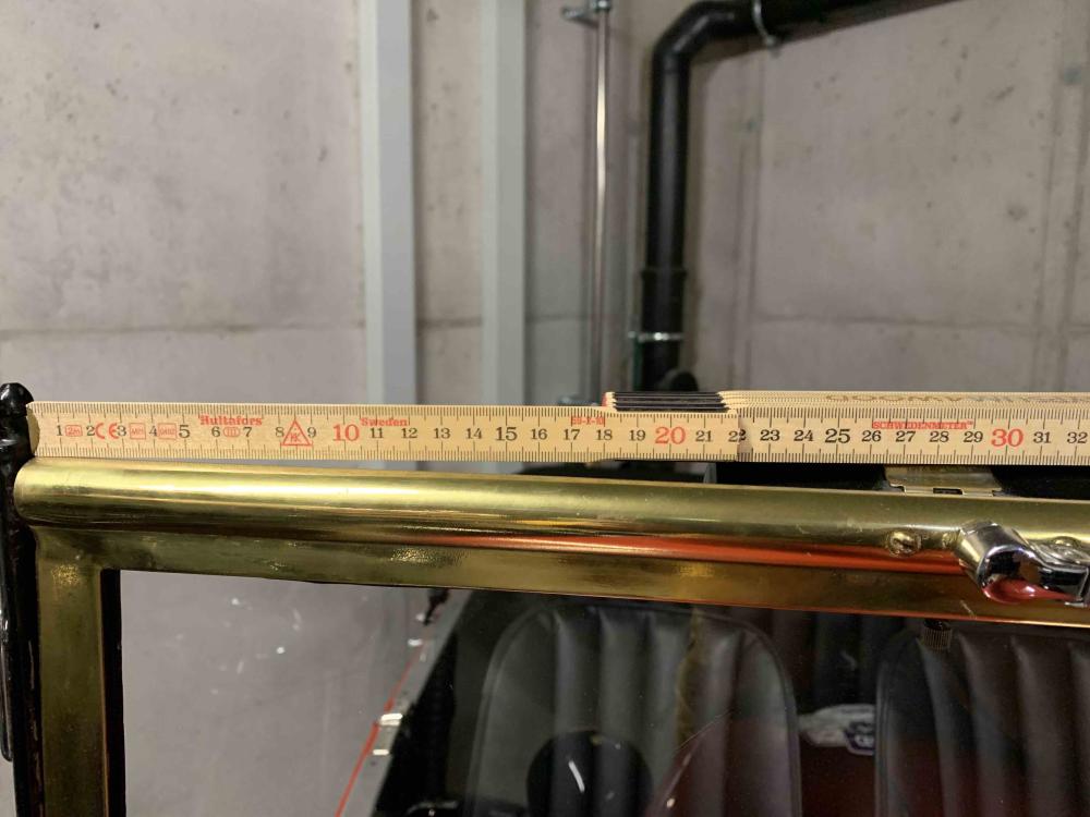

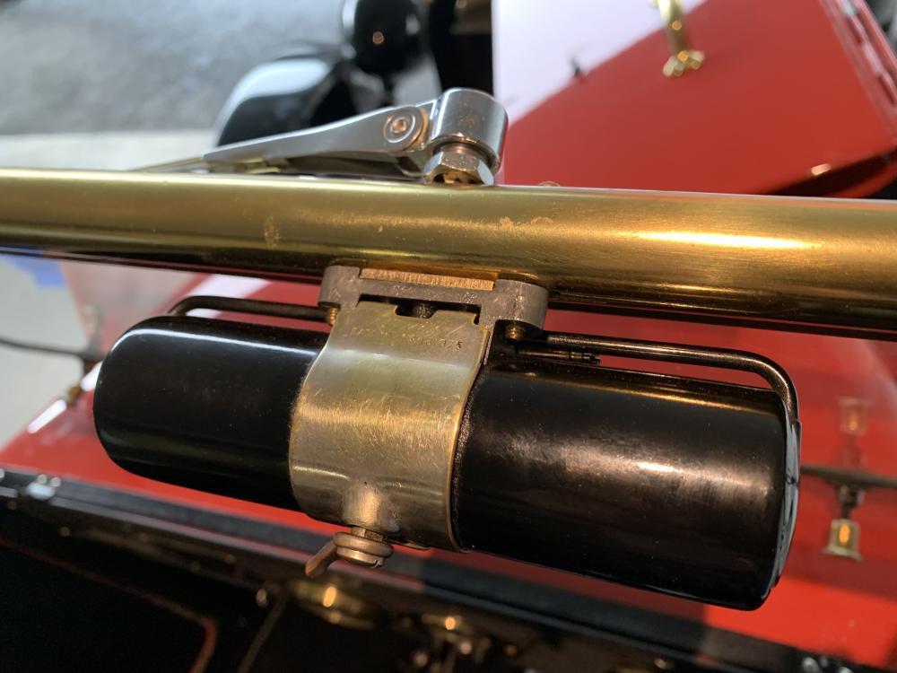

Hi Steve
Look at the foto, there are exactly 28 cm from the screen's outer edge to the middle of the motor. -> 11 in.
But note, this is an AE Tourer, so for the AD 10 in. as Adrian stated I assume to be correct.
