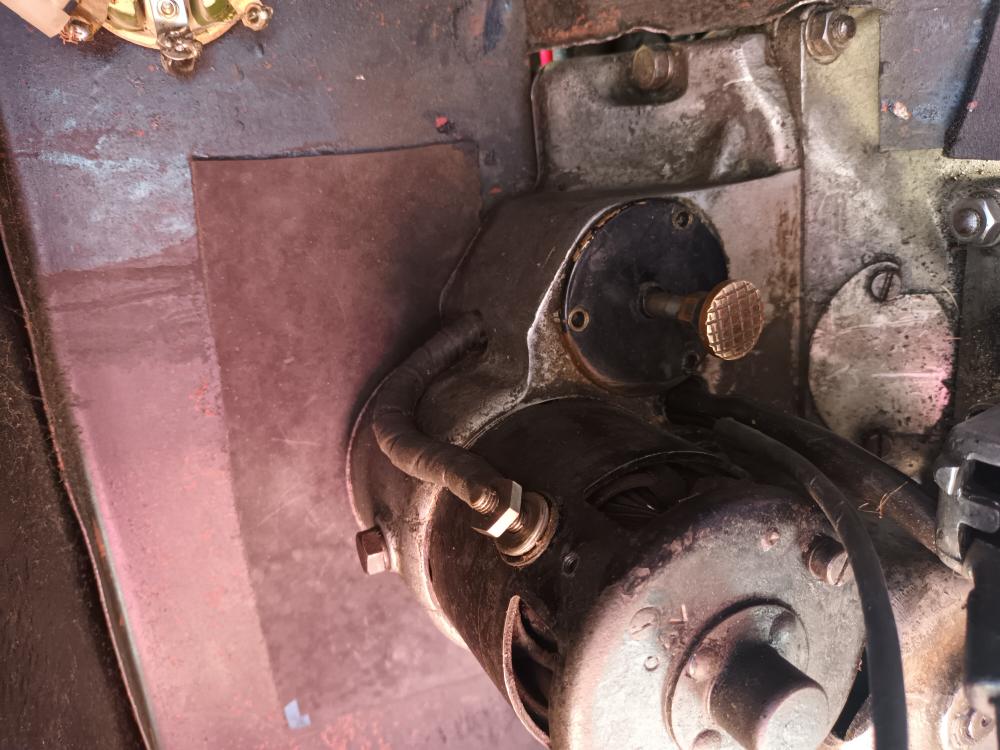

I have a problem with the starter motor foot button next to the clutch pedal. It is stuck and does not press down. I have released the three screws on the cover plate, but the switch does not appear to want to come out of the housing. Do I need to remove the two parts to the starter motor and the button at the same time or should the button come out on its own? The main live connection from the battery is attached to the button with no exposed terminal.

The cables to the switch are so thick and heavy you won't move the switch until they are undone from the back of it.
It is easy enough to remove the whole starter assembly, it is only a bolt on each side, into the crank-case.
It is a bit heavy, though, getting it out from under the dash.

Thank you for your help, it is really appreciated! The starter appears to be in three parts; the starter button along with a top and bottom section to the starter motor. The top part of the motor is shown on the photo and has a black casing with the main live connection terminal, this has 2 long bolts holding it in place. Then there is a silver part to the starter at the bottom which is held in place by three bolts in the crank casing. Both these parts are linked by a gear visible through a small gap.
Do I need to remove BOTH parts of the starter motor to get to the switch terminals?
If I remove them will there be any springs, oil etc when they are removed?
I believe the starter motor has a drive key.

As Simon says, remove the starter assy. off the crankcase top by removing the two long bolts. It is a little cumbersome especially with the thick battery cable attached.
Remove the rear cover - a tin sheet bolted to the unit with several cheese head screws.
Once removed this exposes the rear of the starter button.
Disconnect the battery feed cable from the switch and you can then get the unit on the bench for further investigation.
