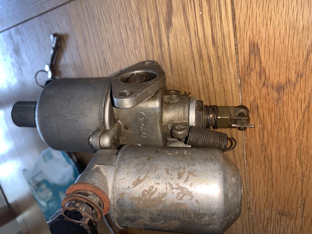

That’s great
I thought I would need a new inlet and exhaust manifold
So is this a UBA or OM
Thanks
UBA. The giveaway is "1930" cast in the side. Wink
