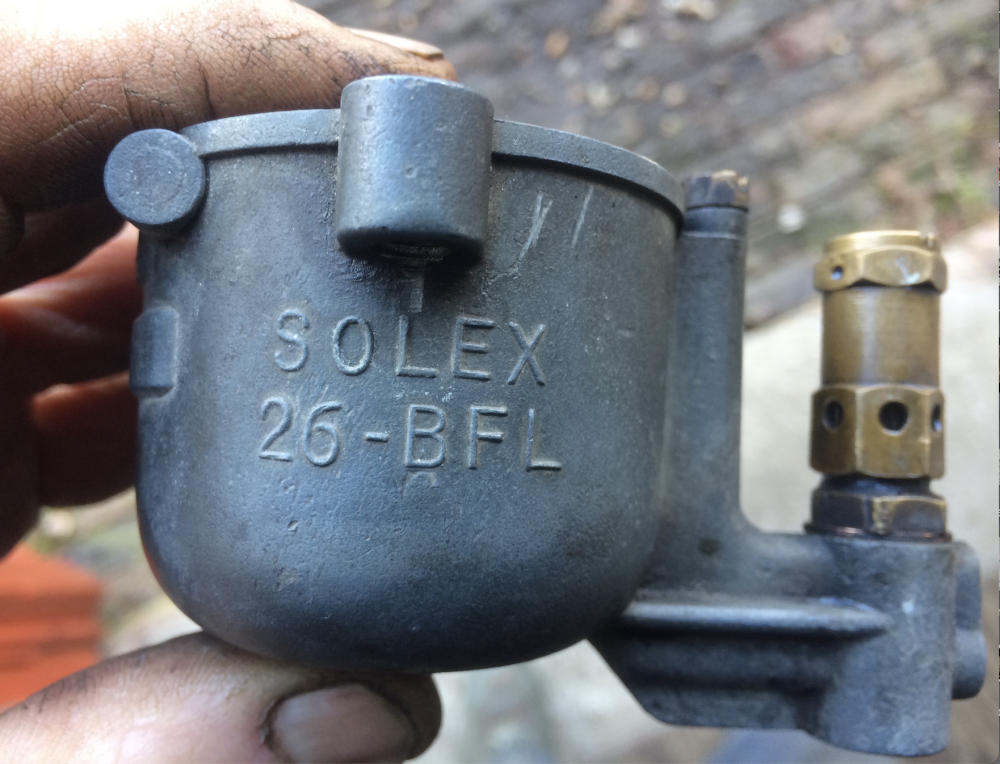

26mm updraft Solex is another, though probably difficult to find, possibility.

Henry's updraft Solex idea - are around but expensive so not worth pursuing.
