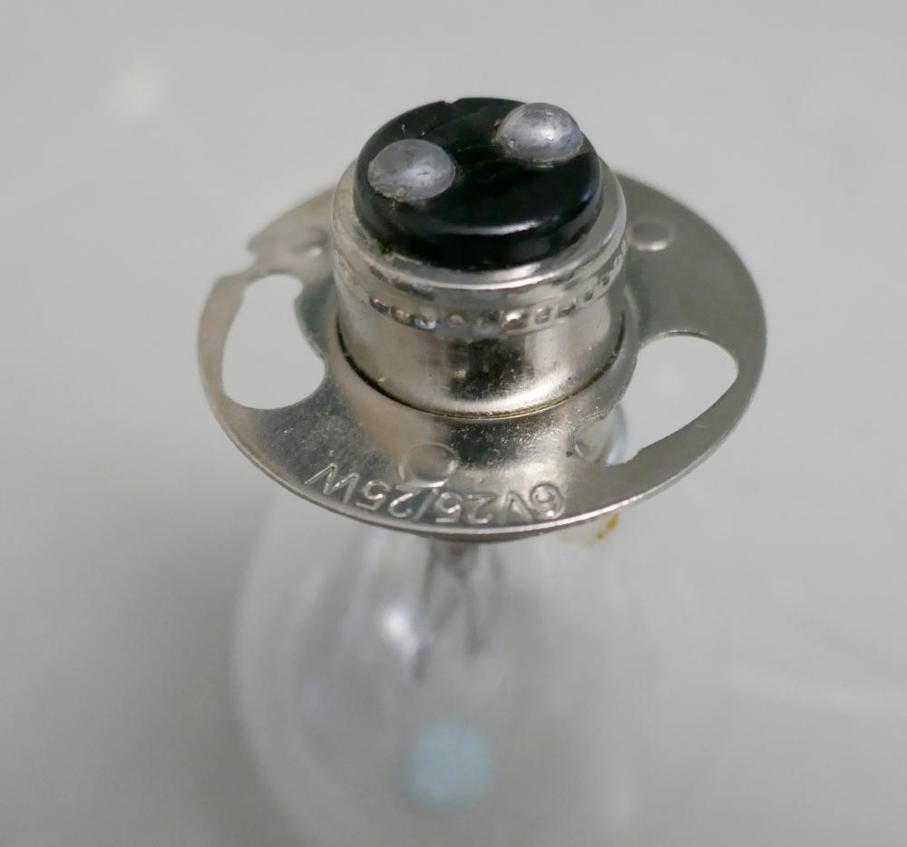

Here's a picture of what's fitted - but I don't know if this is an ex-factory fitting or some modification.
That's an APF (American Pre-Focus)  bulb and certainly not an original fitment.
 I first came across these when they were sold by Dave Phillips of the The Seven Workshop in their excellent replacement reflectors.
I have bought 6v LED APF bulbs from Peter at Classic Regulator and Dynamo Conversions of Lincoln, one of the cherished suppliers.

Thank you, Stuart - wonderful information. I'll get on with sourcing the correct bulbs.
