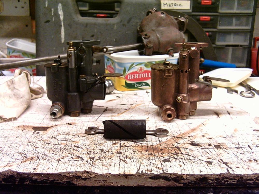

    does it look like these, 22FZB on left, 22FZ on right?
It looks like the one on the left. And is a horizontal. I will give it go at cleaning it

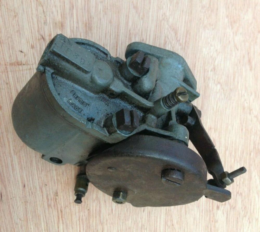

It could be an earlier Zenith, like this:
.jpg   s.d zenith.JPG (Size: 85.18 KB / Downloads: 340)
This is a 30mm on an Austin 12/4, but I've had a Seven running on a 26mm version (possibly from an early Riley Nine?).
