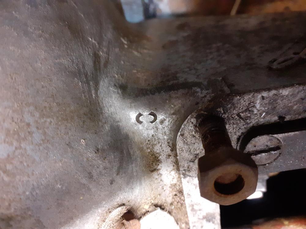

More likely an inspector's stamp I think. I've just checked three gearboxes I can get at easily, a coupled one (1932) has "( )", an uncoupled one (1929) has "O" and the Top Hat (1926) has nothing.
