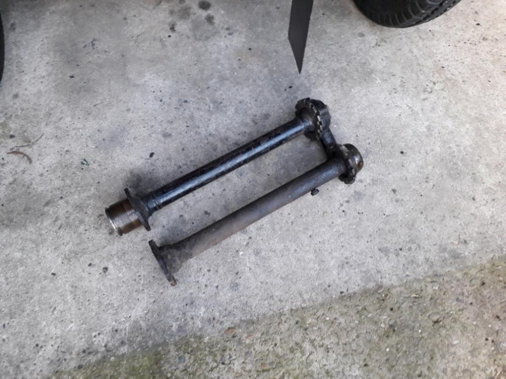

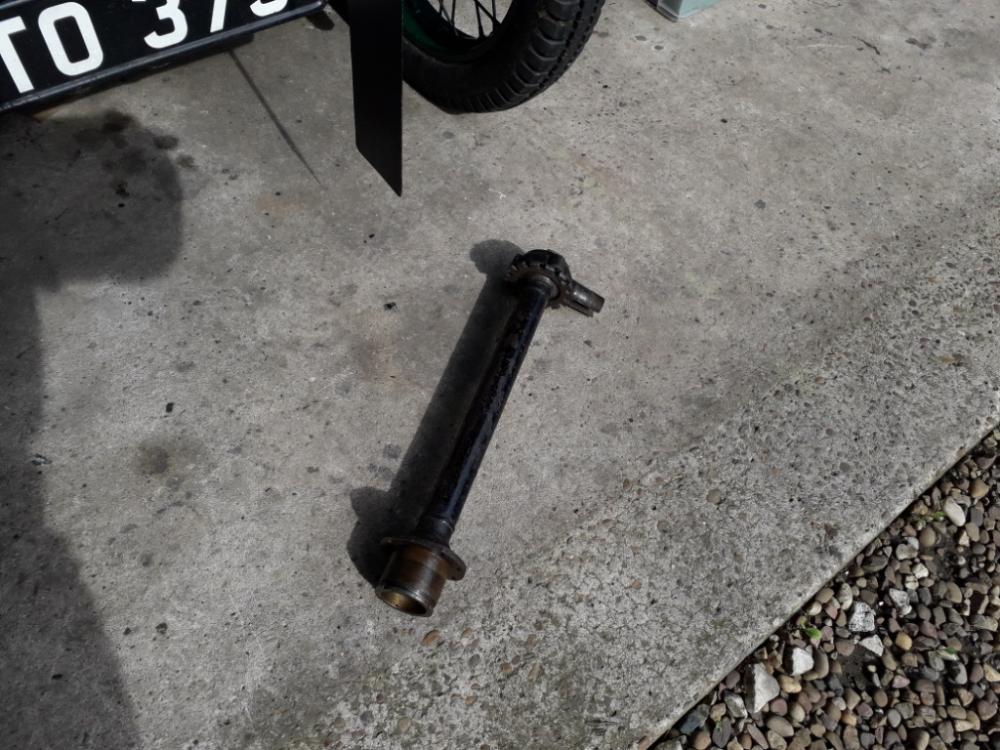

The torque tube you need is specific to the 'Long Nose' banjo you have. Later D type torque tubes won't fit.
The one you need looks like this:
Hi Steve
Thanks.  I had thought that to be the case but needed to check.
Given that the guts from one fit in the other there cant be a lot different.
If I were stuck I would compare casings in terms of distance from the centreline of the diff to the torque tube flange and take it from there.
I dare say a spacer or some milling may be required, dependant where the difference is, and certainly gobbing up the holes in the torque tube flange with weld and redrilling.
Well, of course anything's possible given enough motive, skill and money but in this case, it would, if nothing else, be something of a challenge Dodgy
