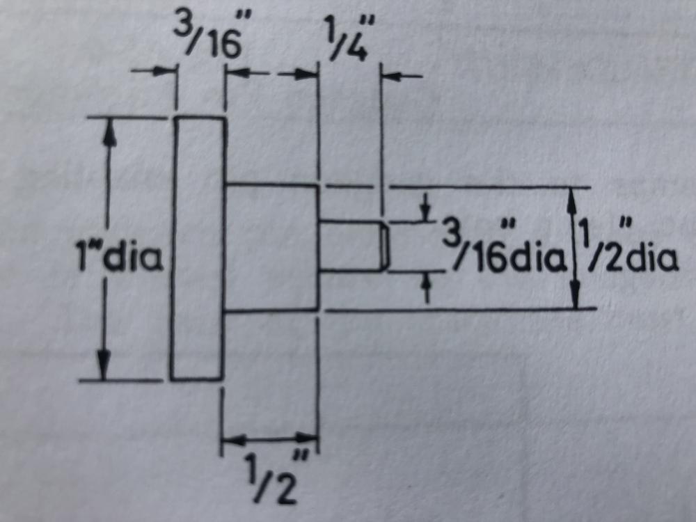

Do I need the 2 vice clamps mentioned in the woodrow manual (see picture), or is there a “home workshop” method?
Two 6mm socket cap screws usually does the trick.
The fancy stepped pieces are only to hold the gudgeon whilst attending the screw. The 1/2 inch part should be slightly reduced .The gudgeons must be supported to avoid twisting the rod. Short pieces of any metal just under 1/2 inch dia can be used. If cut with a hacksaw the ends can be trued in a drill press against emery paper, or pulled down stationary onto a file .

When I did my engine I just wrapped the piston in plenty of soft rag and gentle held them in the vice. Just to tap the locking tabs back from the bolt heads then undo the bolt. I remove the pins by immersing the piston and rod in boiling water and then the pins just push out with a wooden loose fitting dowel. I reinstate in a similar manner.
