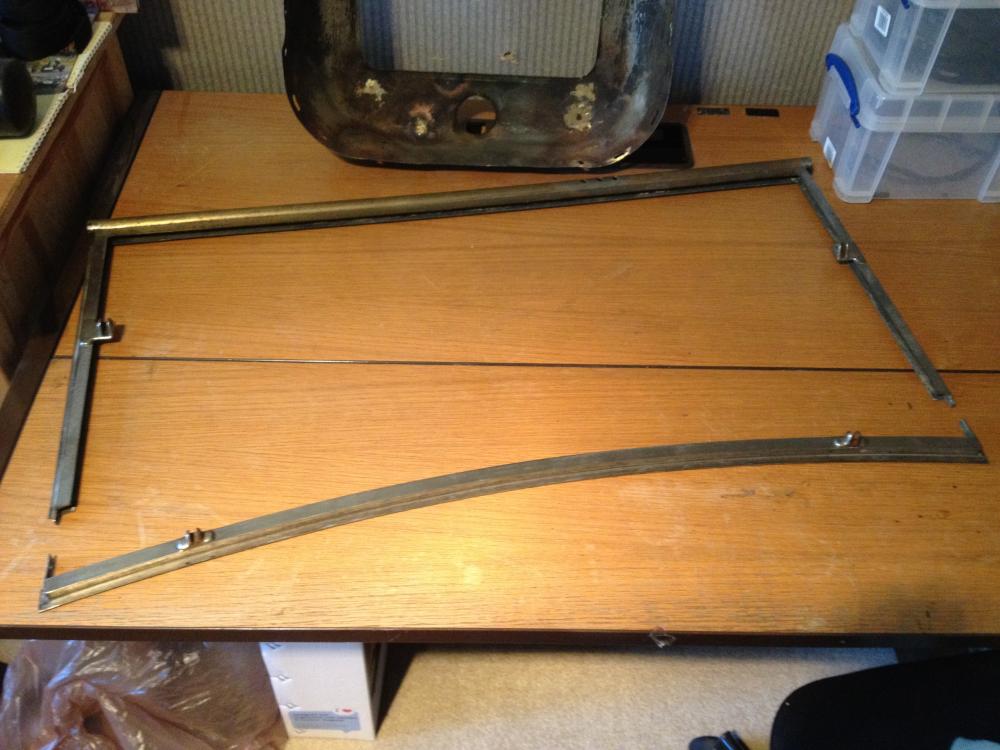

I am working on an RK front windscreen. I wanted to replace the glass, but the screen would barely open - so I have removed the whole frame from the car. Bottom rail is off and glass removed. Despite soaking the assembly in Diesel and then Plus Gas, I can still only get 2" opening of movement. It appears there is a steel tube inside the brass chromed outer tube that is the top rail. The inner tube seems to be one piece for the full width. I can tap it about 1mm sideways at one end and the other end moves. I can just see the inner tube through the 3 wiper mounting holes and it is just moving slightly. If I lever the frame bracket up at one end, the other end moves with it. This all suggests it is one piece?
I cannot for the life of me see how it was put together! There is no sign of welding of the frame bracket to the inner steel tube, which is what I expected.
I am hoping that somebody out there must have taken a frame apart for repair or re-chroming, how is it done?
Thank you in anticipation.......

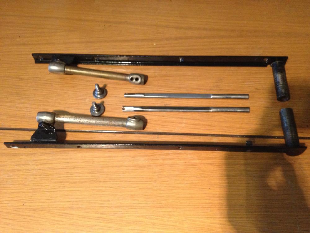

I'm afraid I can't be much help but the disassembled windscreen shown in Peter's photos are exactly as my RK screen when I took it apart. The side irons only have a short piece of tube fitted into the top rail. It sounds as though someone at some time has done a " modification " , but I can't see how it was done (?)

Peter's photos show the standard method of construction on both RK saloons and AD tourers; the steel 'pins' are a reasonably tight fit in the brass tube with insufficient clearance for a second tube. If your assembly has got a second tube installed, then the pins have been replaced or turned down.
