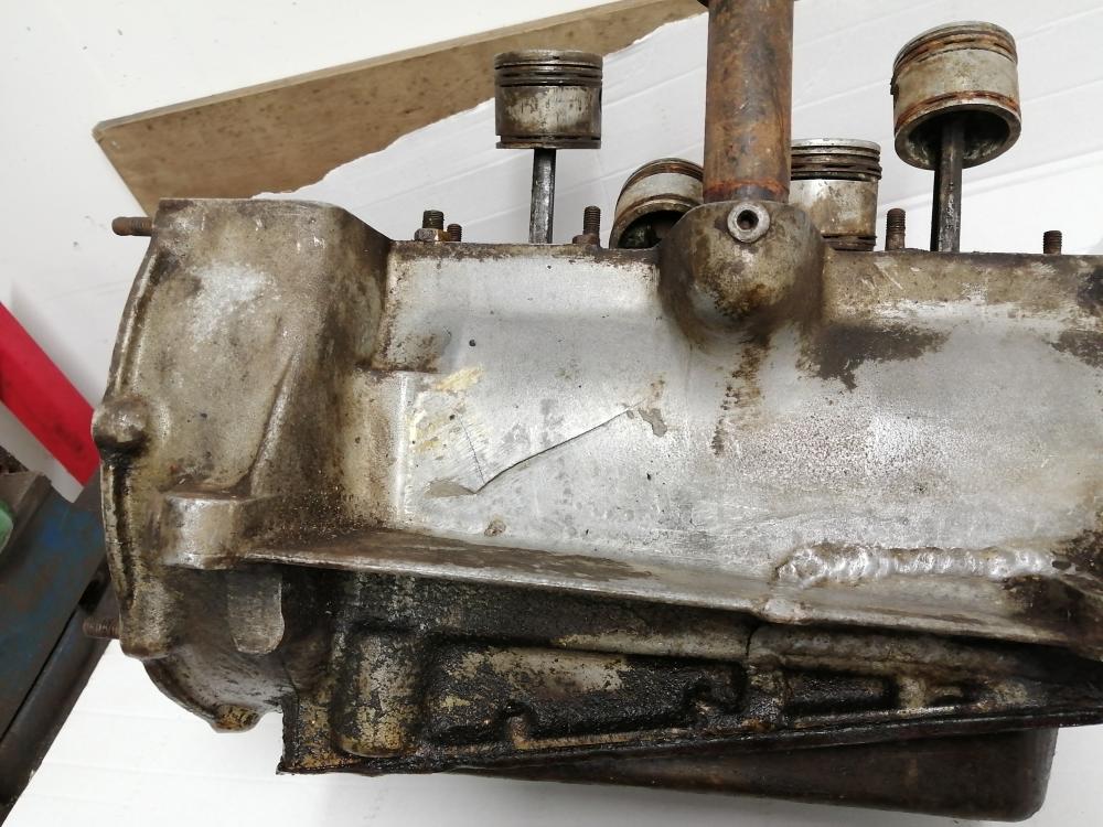

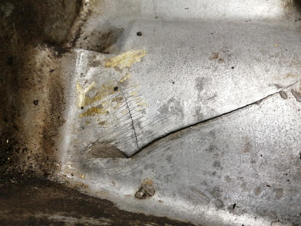

What are peoples thoughts in the best way to repair a crankcase?  This one looks like it's been repaired in the past, unsure if it's still holding but have it in a diesel Bath at the moment to clean it all and will give it a better inspection.
If you're really determined to keep going with that one John I guess a skilled welder could sort it out.
In the old days it would have been patched most likely with a plate and a few bolts (after drilling out the ends of the cracks and removing anything liable to come loose).
That's a fair big area to patch though.
Given that it already has a large welded repair I think you need to be mindful of potential distortion / alignment issues; and look carefully for other damage you may not have spotted yet.
I'm not sure if this is a joke or not.

Cost of repair will far exceed cost of a replacement, I wouldn’t bother.
As said good used are readily available.
I agree with Peter but if you've some great need to have it repaired, laser welding would be the best option as it wouldn't lead to any (further??) distortion. However, the cost is likely to be greater than the cost of a replacement crankcase.

What has been happening to that crankcase? The somewhat rough welding visible in the photo and the big cracks, what do they indicate and what should the rest of us look out for?
Steve,  I think the old welding is quite neat. I must have very low standards.

If its the original crankcase for the car then its worth repairing. ( By a Specialist Alloy Welder )
If its not a numbers matched engine then look at finding an economical replacement.
