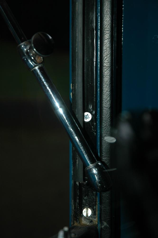

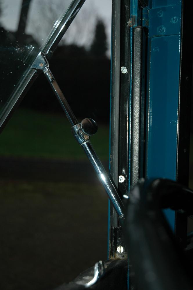

        When I refitted my repaired RK windscreen the Rubber seal I used was: RM19 from Vintage Car parts (Paul Beck). I put the flat bit behind the steel screen fixing frame then put the wood screws through the frame and the rubber. The curly bit is pushed back when the window is closed. I cut a bit out of the very bottom ( about one inch or so) part of the curly bit to allow clearance for the window to shut - a bit of care needed here to keep it snug and the rain out. Take the screws out of the Steel screen mounting strip and make sure there is enough room to allow the thickness of the rubber behind. It all worked well for me and I was pleased with the result and my wife  says: "no water drips now"!
Some pictures for you:
