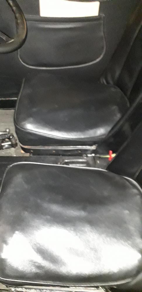

Hi, I’m new on here. A friend has an Austin Ruby which needs renovating. The person who he bought it from made a start and I’m going to have a go at reupholstering the seats. Apologies I know nothing about cars! I’ve got Rinsey Mills Austin 7 book and have studied quite a few seats on the internet. I’m starting with the front ones. I would like to do the seat squabs with springs however most I have looked at have a wedge shape to them sloping backwards. Does anyone know if this is achievable with springs or are they all foam? The sprung Austin seat renovation I have studied most on the internet doesn’t seem to have that slope. Regards, Tony

The Ruby cushion originally used a Moseley Float-on-Air blow-up assembly (I think it consisted of two separate bladders) which was inserted into the cushion 'bag', and which then sat on a shaped metal base. I don't think a spring assembly would work in a Ruby seat.
Of course you can make slopes with springs, you use different heights in each row.
Not something I would do in a Ruby front seat, though.
I don't own cars with any heritage worth preserving, so I use foam.
Getting the correct foam, which is specified mainly by its density and hardness, in the right grade, in the right thickness,  in the right position, and in the right shape - is not that easy.
What I am trying to say is: is isn't just a case of getting a lump of any old foam and sticking it on the seat base.
