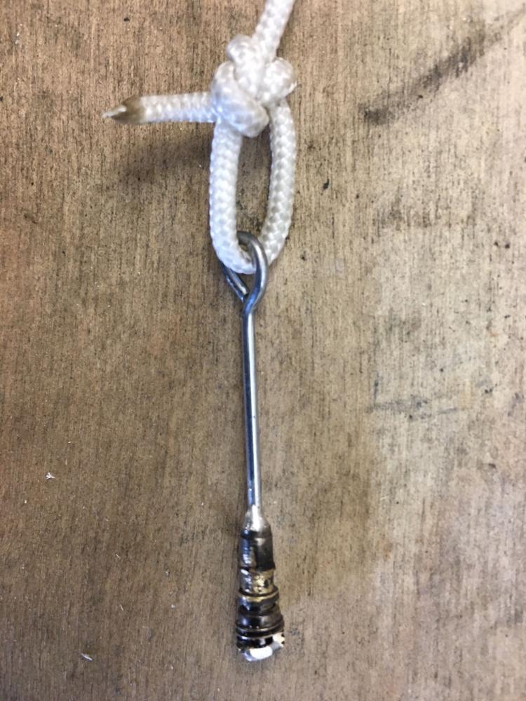

When fitting tyres, the one thing I've always struggled with is getting the valve through the hole in the rim. The answer is obvious, now, and like all the best ideas, simple. Thanks, Dave.
#43
If you're tight fisted like me and Wortles, all you need is a metal dust cap and a length of string/wire. Just drill an 1/8" hole in the dust cap, tie a figure of eight knot in the wire/string so it doesn't pull through and job done.
#44
My metal dust caps are too big to go through the stem hole...
#45
Me too. Just tried it on an empty rim.
#46
I didn't bother trying, I knew it wouldn't go
#47
Good point, Barbera. I never checked because I haven't got a wheel spare to play with. I will try plan 'B' using the internals of a valve so it screws into the inner thread on the neck...
#48
I made a Mark 1 today. there is so little for my stubby fingers to grip and the 36 tip * 5.1 thread is impossible to reproduce I drilled the hole out to 1.5mm andĀ soldered a piece of steel wire into a valve body. I'm hoping that this will ward off future punctures on the reverse Sod's Law effect...
